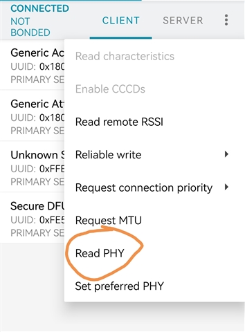

When these two boards are connected, the transmission rate between them is 500~600kbps. However, when the slave is directly connected to the mobile phone, the transmission rate is 500kbps(1Mbps) when the phy is 1M(2M).Therefore, I don't think I have successfully changed the phy of the master to 2M, though I did get a 2M phy from the read phy function in my mobile app--"nRF Connect".
