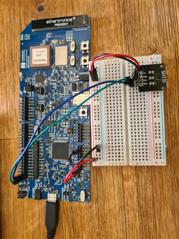

Help connecting I2C temperature sensor to nRF9160DK
Hi Nordic Team
I have been successfully using the nRF52840DK to create various Bluetooth sensors, including a thermometer sensor.
I bought a nRF9160DK with the intent to create an IoT thermometer sensor using NB-IoT.
I am having trouble getting the nRF9160 to recognise/find the attached SHT31 sensor. I have used this exact same sensor with the 52840 Dev Kit without any issues, so I thought connecting it to the 9160DK should be simple...
I have tried a number of different approaches but I can't seem to get this working. Could you please have a look and let me know if I am doing anything wrong with the setup or connecting the sensor to the 9160DK?
I created a very basic app (attached) which I think should include all the elements to get this sensor identified and connected. The app compiles but the output is always "Could not get SHT3XD device".
I have tested the sensor on another board (not a 9160DK) and it is working.
The sensor datasheet says it can operate from 2.5v to 5.5v so I tried switching between 1.8v and 3v using SW9 on the 9160DK with no change.
There is definitely voltage going to the sensor. I even tested the wires and they are all fine. Not sure what else to look for.

  • Hi Gary,
    Thank you for contacting DevZone at NordicSemi.
    Your query is regarding using an overlay file to connect a (temperature) sensor to I2C of nRF9160DK.
    Thank you for attaching your files. When I compiled your project, it showed me warnings (shown in the image1 as well) that the "sht3xd_init" is defined but not used.
    As per your overlay file, you are connecting your sensor to to I2C1. When I looked at the complied device-tree, I found that I2C1 port is disabled. You can see all this in the image1.
    image1:
    I kept all other things same and updated the overlay-file. So basically, our I2C1 was not getting enabled, but rather some other ports were getting enabled, which were in conflict with our requirements. Therefore, I had to disable them in the overlay.
    You can see in the image2 below, which is showing the compiled device tree after changing the overlay file. We can see that I2C1 is enabled and connected to the sensor.
    image2:
    I am attaching overlay file for your reference. Hope it helps.
    N.B: I have moved the overlay file outside of the boards folder and placed directly in the project folder (where we have prj.conf).
    Naeem
  • Hi Naeem
    Thank you very much for your detailed response.
    Unfortunately, I am very confused because I don't see the same results in the build output or the compiled device tree that you have.
    My build output doesn't mention "sht3xd_init" is defined but not used and my overlay file shows that the I2C1 is "okay".
    I have attached the both files from my side.
    I assume the compiled device tree is the zephyr.dts file in the build folder?
    (I have renamed zephyr.dts to zephyr.txt to upload it here as your system won't accept a .dts file).
    I have also moved the .overlay file to the project folder and used your overlay file as the template but it is still failing to detect the sensor.
    Can you let me know what version of the SDK you are using? Perhaps something is wrong with my version (2.0.0) that is causing issues?
    Lastly, can you please let me know what is in conflict that is fixed with your .overlay file?
    In the nRF9160 Product Specification (v2.0) in section 6.17.1 it talks about shared resources and the need to disable peripherals with the same ID. In the Instantiation table (4.2.2) on page 24 it shows the address for the TWIM1 interface as 0x50009000 which is shared with SPIM1 and UART1, both of which are disabled in my device tree.
    Have I missed something?
    Thanks for your help.

  • I use a SHT3x sensor with a nRF9160-DK and Thingy:91.
    The very first decision required is, which VDD IO is to be used. The SHT3x operates from 2.15 to 5.5V. If operated e.g. at 3.3V, a I2C bus with 1.8V will not work. For the DK, you may use SW9 to select 3.3V for VDD IO. If you require 1.8V VDD IO for other reasons, you may try to operate the SHT3x at 2.2V or use a I2C level shifter (e.g. BSS138).
    Once that's done, using it is quite easy, the I2C definitions are already done for the DK or Thingy, you only need a overlay for the SHT3x, e.g.
    sht3x.overlay
    and then use the common zephyr sensor API.
    environment_sht31.c
    (It was working for NCS 2.0.0 for the DK and Thingy:91, for the NCS 2.1.0 I only tested it with the Thingy:91).
    Edit:
    I (re-)tested a SHT3x with a nRF9160-DK using 3.3V VDD IO and NCS 2.1.0. It works on my DK. I use the same wiring as in the picture.
    Maybe you try to remove the I2C setup and use that of the board definition.
  • Hi Achim
    Thanks so much for your input. I very much appreciate it!
    In my haste in testing Naeem's feedback and updated overlay file, I completely forgot to set SW9 to 3.3v.
    Once I changed it to the correct voltage, the thermometer is now being correctly detected using Naeem's version of the Overlay and moving the location of the overlay from a /board folder directly to the root project folder.
      I would still like to understand how your changes have fixed my problem. What specifically was I doing wrong?
  • Hi Gary,
    Yes, you are right that several interfaces share the same base address, and that's why we have to turn them off.
    TWI (M/S), SPI (M/S), and UARTE interfaces share same register base addresses.
    When I complied with your overlay, I got the error that only one of these interfaces could be enabled (snapshot attached below). So, I went to the compiled DTS, and looked for enabled ("okay") devices, and those which were having same reg. So, I updated the overlay file to disable those interfaces.
    So basically, we need to disable uart1 that is conflicting with our required interface.
    &uart1 {
    	status = "disabled";
    Just addition of this code in overlay should suffice.
    (Previously I disabled 3 ports, but you just need UART1 to be disabled).
    Naeem
  • Hi Gary,
    &uart1 {
    Naeem
