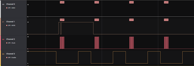

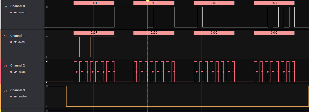

HI , I am having difficulty in interfacing the flash with my DK board
1) The spi flash sample is getting stuck at flash erase function without any error responses
2) I have used SPI interfacing with other devices and it is working .
3) Flash Board has been tested with other controllers
4) I wrote a sample code to just read manufacture id from the flash but it is not giving any response , the code and logic analyzer capture is below

Working Capture for reading ID
My code output Capture

  • Hi , so I have been able to get some response from the flash (not correct),
    I wanna know , how can I change the spi modes
    i.e. - CPOL &CPHA
    2nd
    how can i use spi without including a CS pin configuration, I am using a gpio as cs pin.
