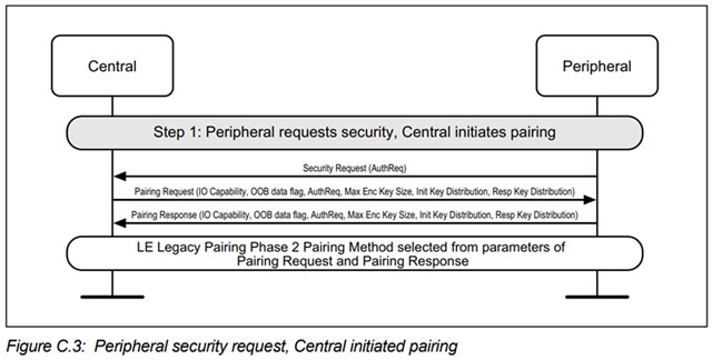

Here is my test step. (Nordic: peripheral role)
1) Nordic begins advertising (custom UUID like peripheral_uart sample)
2) Android app gets predefined bt mac (example 00:16:7F:11:22:36).
There were no BLE scan. and connect to Nordic.
3) Nordic connected and initiate pairing
bt_set_bondable(true);
bt_conn_set_security(conn, BT_SECURITY_L4);

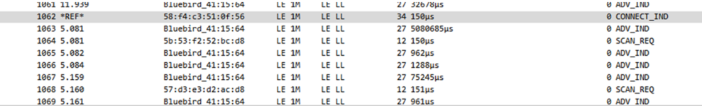

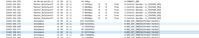

BTW, Nordic required sniff log for analyzing pairing error. However, I hardly get sniff log.
I can get CONNECT_IND then drops next packets. Do you have any idea?
nrf_sniffer_for_bluetooth_le_4.1.1

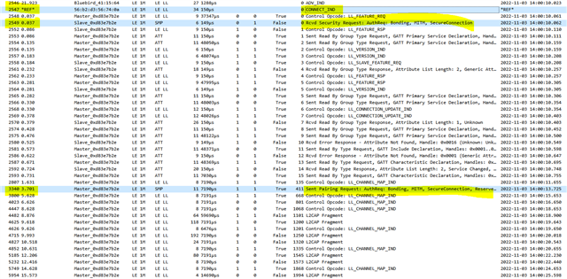

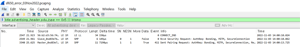

    sniff.7z
    sniff log is uploaded as well as rtt log.
    Your message will be forwarded to MTK HQ again.

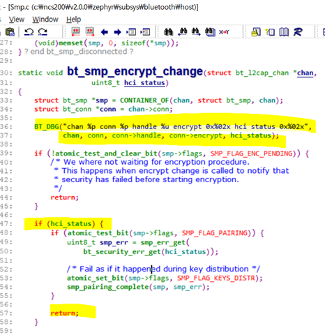

    I have no idea what made following error. Can you please find in sniff log?
    00> D: chan 0x20001f4c conn 0x20001c88 handle 0 encrypt 0x00 hci status 0x1f

    On my end, I attempted to pair using bt_conn_set_security() as you did, and both my Android phone and my Windows PC can bond with the device without any problem.
    Pairing at Security Level 4 like you are trying to do also require an out of band verification method. On your RTT log I don't see signs of this happened. What did you do to achieve this?
    That is not an error. It is most likely just a log from smp.c. See sdk-zephyr/smp.c.

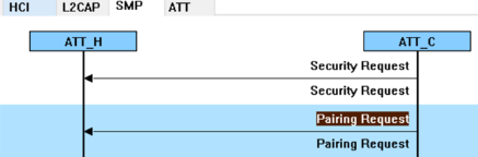

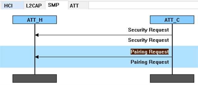

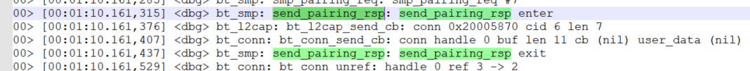

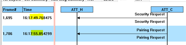

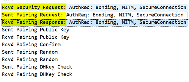

  • 1. The link was wrong.
    [nRF Connect SDK]Force to make pairing(bonding)
    In original case, I did lots of test to know root reason. Now it made us confused.
    In this case, I will do test one scenario to make it simple.
    Here is NG video and normal operation video clip.
    (Android reboot-App launch-connect-failed: NG.mp4, most of time it fails)
    then I retry to connect, it will be okay : OKAY.mp4, most of time it succeeds)
    2. Does MTK mean MediaTek? Yes
    3. What reasoning ...
    Because they initiate paring process, but they believe Nordic made timeout error.

    5. Pairing at Security Level 4 like you are trying to do also require an out of band verification method. On your RTT log I don't see signs of this happened. What did you do to achieve this?
    -> I cannot understand "out of band verification method".

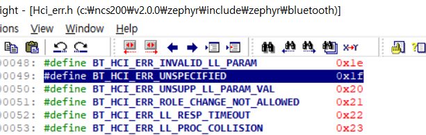

    6. "chan 0x20001f4c conn 0x20001c88 handle 0 encrypt 0x00 hci status 0x1f"
    You though it's normal. But, in smp.c if hci_status is not zero, it is error. (please see hci_err.h)

  • I review Bluetooth core spec 5.3 regarding LE pairing sequence.
    As I mentioned, MTK(Android) connect my project (Nordic), Nordic send security request when connected. (My project requires secure connection).
    sf650_error_03Nov2022.pcapng
    But Nordic did not send "pairing response" And send "time out error" (7 seconds  later after connected)
    Where is from "hci status value 0x1f" ? Is it from MTK?
    Can you please explain it? Without it, we cannot go proceed.
    You are right that it is indicative of an error. I'm sorry about missing the bad hci_status.
    As you can already see, the error state name is not very descriptive. I will need more time to check on this.
    What I can tell you now is that it most likely comes from the internal working of the HCI layer in the nRF device. What triggers the device to go into this state is the part that need more investigation.

    We should provide MTK an air log to show their error. Then we can close this case.
    Nothing in the sniffer trace indicates what is wrong yet, unfortunately.
    It seems encrypted message of the pairing exchange was not there.
    Could you capture one more time following the guide on this page. We need to see the pairing packages if we want to analyze through the sniffer trace.
    https://infocenter.nordicsemi.com/index.jsp?topic=%2Fug_sniffer_ble%2FUG%2Fsniffer_ble%2Faction_paired.html
    Hieu

    2) Here is pairing sequence in success case.
    Here is failure case.
    Nordic sent security request.
    MTK sent "Pairing request", but Nordic did not send "Pairing response"
    No "Pairing response", No user confirmation.
    3. "hci status value 0x1f"
    Let's focus it first. I believe you can give me any explanation.
    then I'll forward it to MTK.
  • I test again with more log option.
    1. Pairing request was received after 5 seconds.
    2. RTT log at failure log.

    00> [00:01:11.916,839] <dbg> bt_smp: smp_pairing_complete: smp.c 1863 status 0x8
    00> [00:01:11.917,083] <dbg> bt_keys: bt_keys_clear: 47:95:91:6C:DF:D7 (random) (keys 0x0000)
    00> [00:01:11.917,358] <dbg> bt_keys: bt_keys_clear: Deleting key bt/keys/4795916cdfd71
    00> [00:01:11.917,449] <dbg> bt_conn: bt_conn_security_changed: conn.c #1 1986 hci_err(0x1f) bt_security_err(9)
    00> [00:01:11.917,480] <dbg> bt_l2cap: bt_l2cap_security_changed: l2cap.c #1 hci_status(1f)
    00> [00:01:11.917,510] <dbg> bt_smp: bt_smp_encrypt_change: chan 0x20005b2c conn 0x20005870 handle 0 encrypt 0x00 hci status 0x1f

    It seems Pairing response was sent but Android did not receive it.
    Can you please review rtt log?

    00> [00:01:10.161,315] <dbg> bt_smp: send_pairing_rsp: send_pairing_rsp enter
    00> [00:01:10.161,376] <dbg> bt_l2cap: bt_l2cap_send_cb: conn 0x20005870 cid 6 len 7
    00> [00:01:10.161,407] <dbg> bt_conn: bt_conn_send_cb: conn handle 0 buf len 11 cb (nil) user_data (nil)
    00> [00:01:10.161,437] <dbg> bt_smp: send_pairing_rsp: send_pairing_rsp exit
    00> [00:01:11.917,785] <wrn> peripheral_uart: Security failed: 47:95:91:6C:DF:D7 (random) level 1 err 9
    00> [00:01:11.918,029] <inf> peripheral_uart: Pairing failed conn: 47:95:91:6C:DF:D7 (random), reason 9
  • Hi Tim,
    Tim Hwang said:
    1. NFC
    I could reproduce this issue without NFC tagging. Let's discuss later. It is not root reason; I think.
    You misunderstood. I mentioned NFC as an example of an out-of-band (OOB) verification method. NFC should not be the problem here.
    Tim Hwang said:
    If Key exchange is a matter, we always see this issue. But it is not. What do you think about that?
    The problem is exactly that: I don't know what to think about that.
    Please take a look back at your videos. What I see are
    - Incorrect passkey error message from the "not-good" video.
    - Passkey pop-up in the "okay" video
    - Very short time between passkey pop-up and the connection is made in the "okay" video. Too short for actual passkey to be entered by a normal human.
    The combination of those makes no sense at all.
    That is why I hope a sniffer log containing the encrypted pairing packets would help me see what is wrong here.
    I might guess that your Android device asks for passkey, but doesn't handle the passkey well, sometime consider "no" passkey as good, sometime doesn't. Without a sniffer, I can't be sure.
    Therefore, if possible, please look into getting me that sniffer log with the pairing procedure. Preferably one of a success case, and one of a failure case.
    I will look at your RTT log Tue and Wed. Unfortunately, I am partially out of office both days, so my follow-up might be delayed until end of Thursday.
    Hieu
