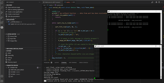

I am having a normal DC motor with encoder, encoder is based on the interrupt. After motor runs for x number of ticks I have to stop the motor. The value of x, receiving from another board using UART bus in cJSON format.
If I comment out the code from line number 170 to 174 in main.c file that motor is rotating otherwise not I am not able to debug the issue why it is happening?
Please let me know if some more information is required here.
Also I am not able to get the print statement output on the nRF terminal as well as putty terminal. Earlier it was working but with same code suddenly I am not able get print statement on th nRF terminal and putty application terminal also.
Please help me with this issues.

    As I see you are facing two problems. One that if you comment code (line 170-174) then your motor is rotating.
    And the other one that you are not able to see output on terminal.
    Firstly, when you build your project and connect DK to the computer, your VS CODE will have the COM port numbers for the DK.
    I connected to both of the COM ports (that VS CODE was detecting) using putty with 115200 baud rate. Please see the attached Image below.
    I think your problem could be connecting to wrong port number or with different baud rate.
    I was able to see the output on both putty terminals. One terminal is printing information (through printk function) and the other one is your serial port.
    Your while loop (line 170-174) will exit once you receive data from the serial port, and then your motor controller would proceed (I guess this is expected behavior).
    Try to provide data from serial terminal (click on second putty terminal and type some data and press enter).
    I hope it works this way as you have intended (as from the comment I can see that the while loop is there to wait for user input).
    However, I do not fully understand your while loop. You can see that you have initialized num with 0, and you are ANDING with variable num in the while loop condition. I can not see the variable num used anywhere else.
    Hope it helps in any possible way. Please note the output I have shown uses a different while loop and does not call for k_msgq_get function. I was just testing the code by providing input from serial terminal.
