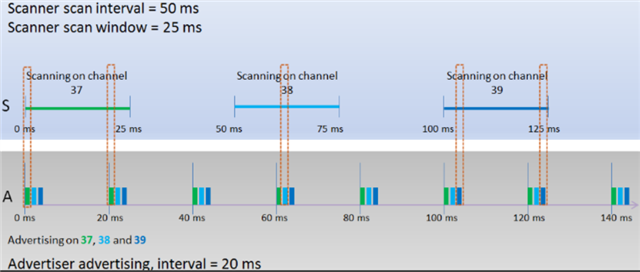

My primary goal is connection success rate and my secondary goal is a fast connection time.  Which advertising method is better: Advertise with a long interval and long window or with short interval and short window?  Is it generally true that if the total time spent advertising is equivalent, the connection success rate is equivalent?  For example I have 2 sets of advertising parameters:
Set 1 - Interval=100s, window=20s
Set 2 - Interval=10s, window=2s
After 100s, is the connection success rate roughly equivalent under both sets?  The peripheral is the nRF and the central is a cell phone so the scan parameters are not fixed but for analysis I am assuming scan parameters are fixed.  Can anyone provide equations for calculating the connection success rate given total time spent advertising, advertising interval/window, and scan interval/window?  I am assuming if the scan window overlaps with the advertising window, the connection will be successful.  Thank you.
