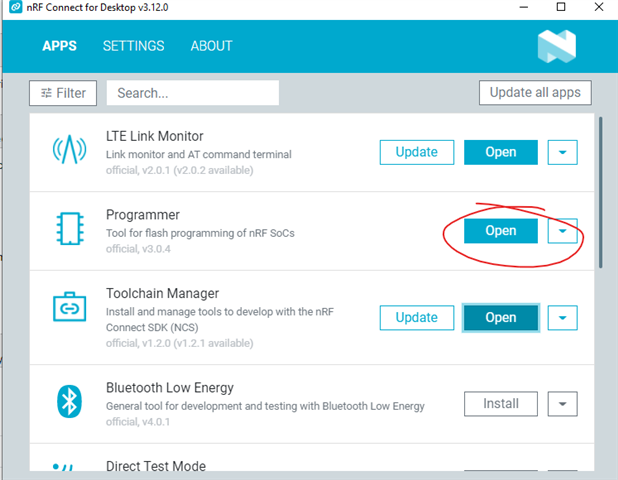

    You can examine the board in the programmer in nRF Connect for Desktop if you're able to find it on your computer. Here you can see if the board has anything on it, and you can recover the device

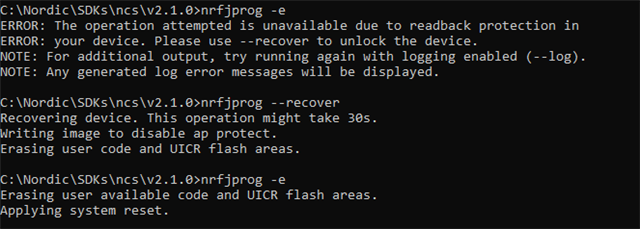

    Another way to do this is again to use nrfjprog in command line. See nrfjprog -h for information about what the various flags and commands does, and then run nrfjprog -e to erase what is on the device. You might be required to run nrfjprog --recover to unlock a device locked by readback protection. See the attached image for expected output.
