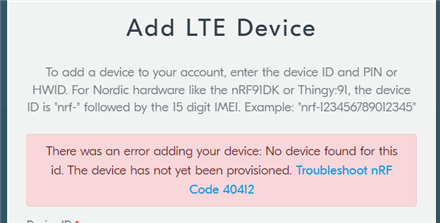

3. I also tried to add the LTE device to the nRF connection, but this was not working

    What version of the nRF9160 Development Kit are you running? When generating new certificates, what device ID did you enter?

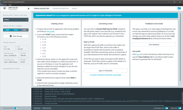

    Please provide full log output from the application you are running on your device, as screenshots provide too little information. You can find the log output in the LTE link monitor on the bottom.

  • Also, please provide full .pcap along with modem trace
  • I'll have to check that out. Regarding the modem trace, I am looking at the documentation right now, Is it possible to run the LTE link monitor and the modem tracer simultaneously?
    Yes, this is possible. The modem trace uses it's own UART port. You can program the nrf9160dk_asset_tracker_v2_debug_nbiot_2022-06-02_880c82db.hex, which has modem trace enabled.
    After doing that you can open Trace Collector v2 from nRF Connect for Desktop
    After clicking start, make sure to reset you nRF9160DK, then you should see the size of the file increase as it tries to connect.
    I'll give that a try, thanks for letting me know. So if I understand correctly, I need to flash an asset tracker debug, and I will be able to run trace collection v2 and change AT commands simultaneously? Please confirm if this is correct.
    Yes, I tested here, and seemingly work out of the box. Note that have captured modem traces on my kit before which may have enabled features. Please try and verify on your side. Best to leave it running for 15 - 30 minutes.
    With the modem trace running you should be able to issue AT commands without any problems through the LTE Link Monitor.
