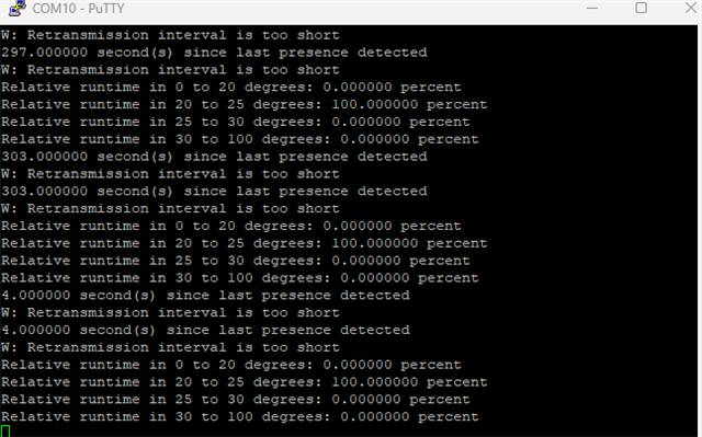

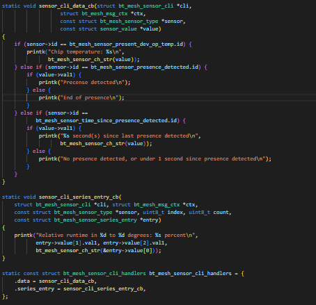

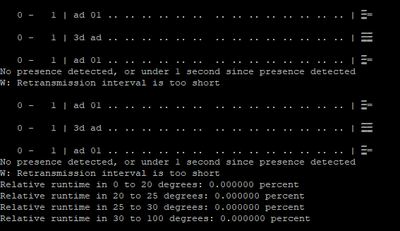

I tried bluetooth mesh sensor server and client example, everything is good including provisioning process in mobile but the output is different with different mobiles. i have 2 mobiles where i tested in both mobiles i get output of this part as shown in picture-1
picture-1
and
picture-2

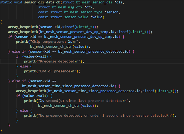

and from the picture-2 of code except chip temperature i can see other printk functions in output.
I tried this in my colleague mobile in that i can see picture-2 outputs but not picture-1 output.
I am really confused, why this happens? Can anyone help me as soon as possible please...

    1. Which devices did you use for the sensor server and client samples?
    2. Could you add the output you see on your mobiles as well?
    3. Are there any differences between the mobiles? Different OS'?
    Andreas

    Sorry for late response. 1. For sensor_server thingy:53 with nRF5340DK and for sensor_client nRF52840DK
    2. From my colleague mobile i dont have screenshot also he is not available now its android and output comes from picture-2 i.e "chip temperature is .. ", "presence detected" and so on. I have two mobiles one is android and other is IOS so in both i could not see "chip temperature" output line its directly jumping to picture-1 i.e "Relative runtime in 0 to 30 degrees : 0.0000 percent" and also i can see presence detected lines when i press button on thingy-53.
    3. Already answered in point 2
    Regards

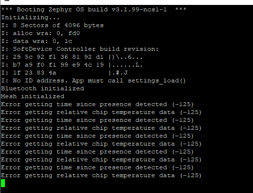

    65.000000 second(s) since last presence detected
    Relative runtime in 0 to 20 degrees: 0.000000 percent
    Relative runtime in 20 to 25 degrees: 0.000000 percent
    Relative runtime in 25 to 30 degrees: 100.000000 percent
    Relative runtime in 30 to 100 degrees: 0.000000 percent
    71.000000 second(s) since last presence detected
    Where it gathers the temperature data from. You should be able to find that.

  • pressing the button on the thingy and you end up in the sensor_cli_data_cb()?

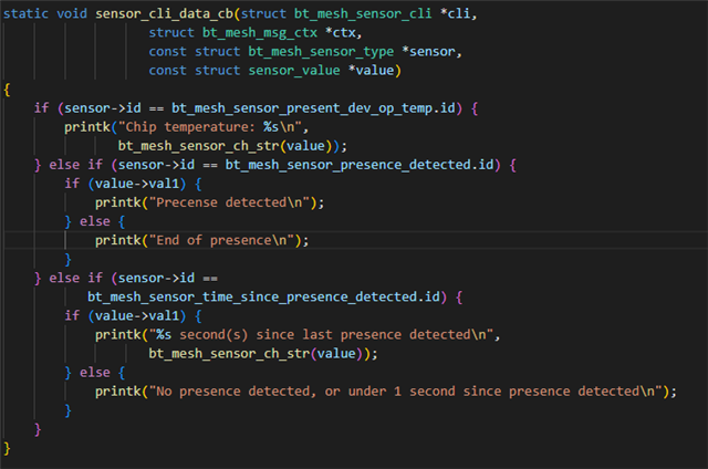

    Yes it goes to
    else if (sensor->id ==
    		   bt_mesh_sensor_time_since_presence_detected.id) {
    		if (value->val1) {
    			printk("%s second(s) since last presence detected\n",
    			       bt_mesh_sensor_ch_str(value));
    		} else {
    			printk("No presence detected, or under 1 second since presence detected\n");
    Already "No Presence detecte, or.....") will be printing and when i press "%s second(s) since last presence detected" will print as follows

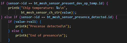

    Its sending to sensor_cli_data_cb() but bt_mesh_sensor_present_dev_op_temp.id and bt_mesh_sensor_presence_detected.id id's are getting different don't know why. and sensor->id ==bt_mesh_sensor_time_since_presence_detected.id these id's are same that's why when we press or don' press that part is being printed.

     this part is not triggering because bt_mesh_sensor_present_dev_op_temp.id and bt_mesh_sensor_presence_detected.id id's are different.

    Logs are coming from sensor_client with me its COM10 which i can see on PuTTY and those are being sent from sensor_server as it is a mesh sample example.
    Where in the sensor server is it triggering the message that triggers the callback in the sensor_client that prints the "presence detected" message. Because by default, it is not set up to send the temperature data. Alternatively, you can figure out how it prints the.
    I know from where it is sending the messages.
    from sensor_server from below part it is sending
    and from sensor_client
     here it receives. as you can see we use sensor types and as far as i figured that is main function to send and receive messages .

    I understand how you want the sample to work, but that is not the way it works by default. The server has (at least two) "sensors". One presence sensor, where changes are triggered by pushing the sensor. Then it has one temperature sensor, which is being sent regularly. What you want is perfectly possible, but it is not what the sample does. This is why I suggested you try to figure out what happens in the application on the Thingy when you press the button, to see how you can repurpose that to send the temperature value instead of triggering the presence detection.
    But sure, let us walk through it.

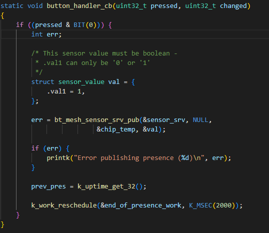

    So something happens when you press a button on the sensor_server application. I want to look for a button handler. In the model_handler.c file in the sensor_server application there is a function that is being called inside model_handler_init():
    dk_button_handler_add(), which initializes a button handler struct called "button_handler". It has one member, called button_handler_cb(). Inside there you can see that it publishes something if the button is pressed:
    		err = bt_mesh_sensor_srv_pub(&sensor_srv, NULL,
    					     &presence_sensor, &val);
    It looks like it publishes something about a presence_sensor. Have you tried changing this to the chip_temp sensor instead?
    Please note that the &val consists of two parameters. One before the decimal point and one representing the value after the decimal point. From it's declaration:

    I suggest that you first try by setting it to a dummy value, to see whether it triggers the correct sensor->id. Then you can try to actually read the actual temperature later.

    I set it to 10 it shows error . Could give me instructions how exactly to do that by any example code attached. It would be great so that i would get exact idea how to do that.
    For val1 to 0 and val2 to 1 it doesn't work as we expected.
    Edit:
    I also changed "presence_sensor" in button_handler_cb to "chip_temp" as below
    Still its printing "presence_sensor". No idea what is going on. Looks like so much struggle to get "Chip Temperature" which is already integrated in the sample program

    Why don't you try to change your button_handler_cb() in your sensor_server application to do this:
    static void button_handler_cb(uint32_t pressed, uint32_t changed)
    	if ((pressed & BIT(0))) {
    		int err;
    		/* This sensor value must be boolean -
    		 * .val1 can only be '0' or '1'
    		// struct sensor_value val = {
    		// 	.val1 = 1,
    			.val1 = 1,
                .val2 = 500000,
    		// err = bt_mesh_sensor_srv_pub(&sensor_srv, NULL,
    		// 			     &presence_sensor, &val);
    					     &chip_temp, &val);
    		if (err) {
    			printk("Error publishing presence (%d)\n", err);
    		prev_pres = k_uptime_get_32();
    		k_work_reschedule(&end_of_presence_work, K_MSEC(2000));

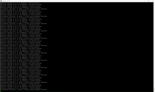

    Then it should print something like this:

    Yes it is the error i am talking about and not any function i am getting and yes later i realised == is not making any sence
    I did still shows nothing
    Regards
    Did you change anything else in the project? Does it work like before if you revert the button handler back to default? Try the attached application in an unmodified (!) NCS v2.1.2:

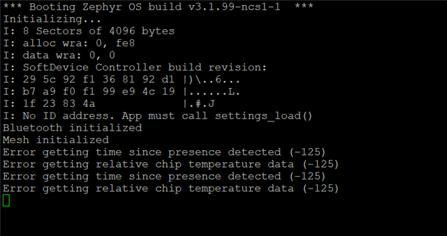

  • Hi
    Have done as you told with NCS v2.1.2 with the server file you attached , still no output looks like its same and no difference ..
    Does it work for you? No idea what have you done different
