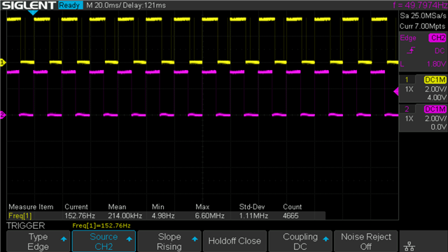

During development, I am seeing a strange behavior when enabling zigbee.
When the application's PRJ file does not enable zigbee, I2C functions as expected. The peripherals can be read and responses are received (as shown in the attached picture)
Without the zigbee/networking processor active, this is what things look like in yellow below:
1. Raising edge I2C transaction started
2. Falling edge I2C transaction completed
The purple  line indicates edges (falling and raising) are a trigger to start an I2C transaction

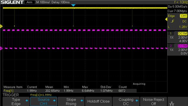

When Zigbee configurations are enabled (w/o even initializing Zboss) All comms on i2c3 time out.
