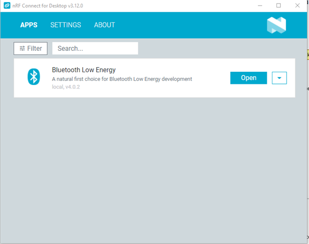

Never mind! I discovered it works under $HOMEPATH on Windows!

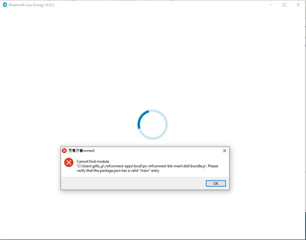

Hi Simnor... the very first app I want to use is Bluetooth Low Energy, github repo pc-nrfconnect-ble-main. When I try to launch the app I get an error that it cannot find a module dist\bundle.js. Where would I find this module?

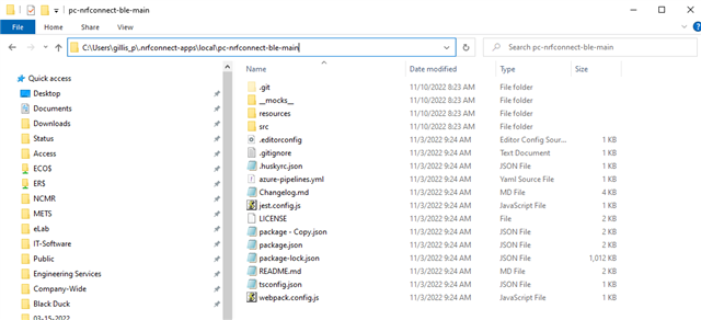

Can you show me the specific error you see when trying to open the application? On my end it is in ...\Users\<USERNAME>\.nrfconnect-apps\node_modules\pc-nrfconnect-ble\dist so you can check that folder, and maybe try getting it from an online computer if it doesn't exist.
Simon
Below is the error. And I confirm that the folder it is looking for does not exist.
