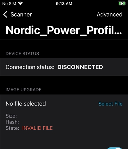

While testing FOTA upgrades it seems ZIP files are not supported by the iOS Device Manager app. Here is the error when I select dfu_application.zip in the Device Manager app:
Is this only a limitation with the Device Manager app? Or is this also a limitation with the firmware? Maybe I am missing some build configuration to enable this feature?

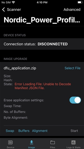

    I tested again today and get a different error from the Device Manager app when I tap on "select file" and then pick the file dfu_application.zip. The error is "Error Loading File: Unable to Decode Manifest JSON File." See screenshot.
    I have attached the zip file.
    8270.dfu_application.zip
  • The new error message is updated by the engineer behind the app when I talked to him about your original ticket. I believed that the app updated sometime during the weekend?
    I tested with an iOS device and an Android device today and talked further with the same engineer. We confirmed that there was some mismatch in expectation of the iOS app and the NCS manifest.json generation, which resulted in the iOS app to complain about the file.
    There should be an app update for it soon and I will let you know here when it is available. In the meantime, I hope that using the .bin file is alright as an alternative?
