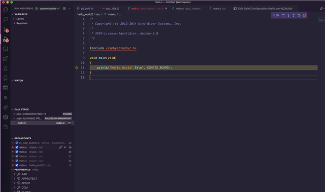

I've attached an image of the setup if that's helpful.

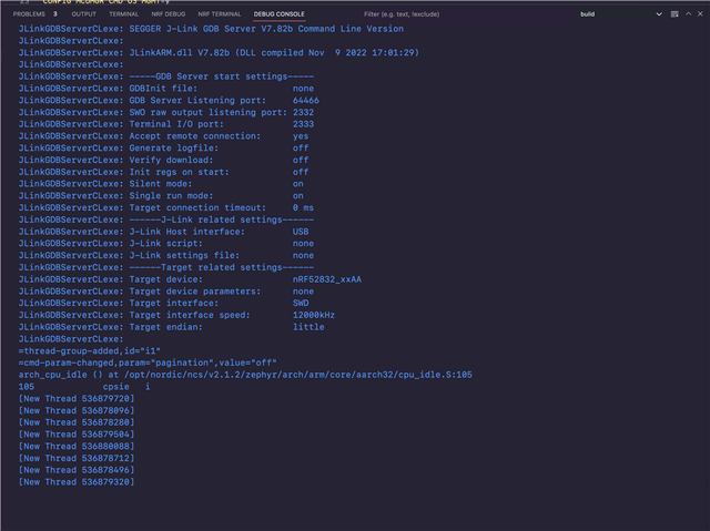

  • Thank you for the quick response. Pressing the Pause button doesn't seem to do anything. The Debug Console window doesn't seem to show any errors (see attached image).

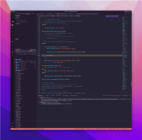

    One thing I tried was disabling the "Enable debug options", creating a pristine build, and running the debugger. This seems to break inside "cpu_idle" when run and then a FIH_PANIC spot (see screenshot) when I hit pause, but continuing doesn't continue past when I hit continue (F5). I assume this is going down the wrong path but maybe it's helpful for debugging the problem?

  • One thing that's a clear difference between the hello_world example and my application is there's no "[Switching to Thread abcd]" after the [New Thread] lines in the debug console output of my application. It's like it gets stuck somewhere.
    Here is the full debug console output for my app:

    =thread-group-added,id="i1"
    =cmd-param-changed,param="pagination",value="off"
    arch_cpu_idle () at /opt/nordic/ncs/v2.1.2/zephyr/arch/arm/core/aarch32/cpu_idle.S:105
    105		cpsie	i
    [New Thread 536879720]
    [New Thread 536878096]
    [New Thread 536878280]
    [New Thread 536879504]
    [New Thread 536880088]
    [New Thread 536878712]
    [New Thread 536878496]
    [New Thread 536879320]

    The CPU registers can be viewed in the top left corner here:
    This shows that the program hangs inside MCUBoot because it did not find a bootable app. This can happen if only the mcuboot image is programmed to the device instead (i.e. if the zephyr.hex in build/mcuboot/zephyr/ was programmed instead of the merged.hex in build/zephyr)
