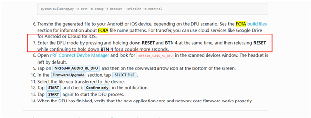

However, there is a problem with FOTA. I don't have external flash, so I want to test the internal flash OTA. I just want to upgrade the APP.
3.First I execute this command:
python buildprog. py -c app -b debug -d headset --pristine -m internal -M -p
Burn the headset program to the development board.
4.Then:
5.In
\nrf5340_ audio\build\dev_ headset\build_debug\zephyr ,i got
app_ Update.bin and dfu_ Application. zip and other files,
6.I can enter the OTA mode, When I used nRF Connect Device Manage for testing FOTA upgrades.It reply: Error, Value 3
Can you tell me where my problem is?
