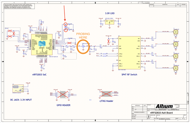

issues when flashing a custom board using nrf52833dk debug port P19
test setup
the custom board schematic
we tried to flash the custom board with the beacon sample here https://developer.nordicsemi.com/nRF_Connect_SDK/doc/latest/zephyr/samples/bluetooth/beacon/README.html
Connect debug out header P19 on DK to jtag-style connector on custom board. Connect custom board to power supply.
Testing as follows:
1.Program the 52833 chip on the dk without the connection above
Result:  success, DK beacons as expected
2.Program the 52833 chip on the dk with the connection above, but do not power the custom board
Result: success, DK beacons as expected. Custom board does not beacon as it is not powered.
3.Program the 52833 chip on the custom board with connection above and power.
Result: DK does not beacon, setup programs custom board only. Successfully program the custom board with no errors in VSCode when connecting or flashing. However, board is till not beaconing at all.
The VS code message for the third test
We then examined the voltage of the chip
Following measurements were done:
Measurement
DK Result
Custom Board Result
Voltage at DEC1
1.1 V
0.75V
Voltage at Vbus
0V
< 0.001V
Following these results, capacitor C24 in our custom board was removed. No difference in measure Voltage was observed. Custom board is still not functional.
Question:
1. did we have a correct setup to flash the custom board
2. what could be the reason that Voltage at DEC1 is not correct on our custom board
Thank you for reading through this problem.

  • Hi George,

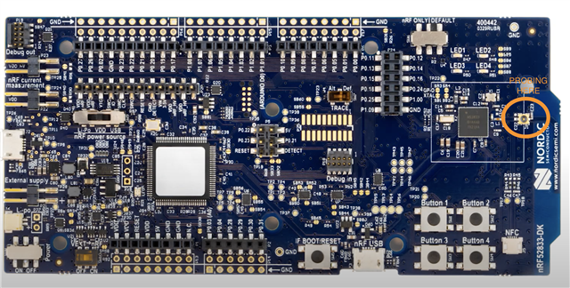

    I looked at your design and you really need much more vias both around the ant path and also in the GND layer on the top layer in general. Also, instead of having a power player in the inner layer, you could route the power in the inner layer and fill the remaining layer with GND. We also recommend having a keep-out area on the inner layers directly under the antenna matching circuitry to reduce the stray capacitance.
    For example, here is the nRF52833 DK:
    regards
    Jared
  • Hello, thank you for the review and providing feedback. We are going to make some changes in our custom design and will share the updated files again for review when they are ready.

    This looks better but some feedback:
    1. Can you route the connection between the DEC4 and DEC6 so that it does not go under the 32 MHz crystal routing, and not spilt up the center pad of the nRF?
    2. What types of antennas will you use? Is this meant to be used for AoA? What will be the spacing between the antennas?
