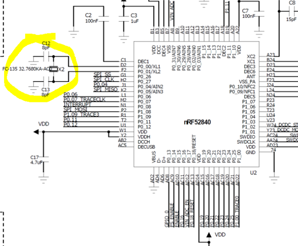

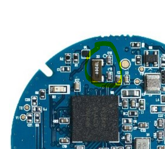

  • Hi Hung,
    I bought the nRF52840 to be able to factory reset the XM/XB122 as in one of my early deployments I managed to "brick" it.  I soldered the SB47 closed on the nRF52840 spesifically to not be able to flash to the nRF52840 and brick that too by accident and to not have power issues while testing..
    I could not find the 32kHz crystal you talk about in the XM122 documentation, but did find a FA-20H 32.0000MF20X-K3 in the XM122 schematics which is a 32 MHz crystal, was your kHz a typo?

  • Hi Andreas,
    I'm not so sure if I'm looking at the same module as you but according to this , it has a 32kHz crystal (X2) :
    I don't know what could be wrong here, but if you are not very familiar with both the hardware and and the software it's not a good idea to jump straight into the bootloader and the buttonless service.

  • Hi Hung,
    Yes we were looking at the same, I saw the Crystal to the top right, just out of your image which also had a 32.0 in the number..  Thanks for showing the right one.
    I am familiar with the samples, I have built and deployed a few, I managed all on the XM/XB 122.  I have even now combined some samples and added own logic to have the functionality I need in my App.  I now measure distance with the Radar and transmit that vie BLE Header which I then read from any BLE scanner.  I am not an electronic specialist, but have been dabbling and programming various controllers for a while now.  I am a programmer, with a lot of aged C and C++ experience that changed to C# over the years.
    Sorry for the long story, but I am past samples now, I need Buttenless DFU working on the XM122, the first steps as you suggest, has been done.  We now need to be able update the pacjaged devices in the field, with no Dev board close.  The last part I then need to figure out is how to add Settings, so we can just update that and not the whole App, but for now BLE DFU will get us going.
