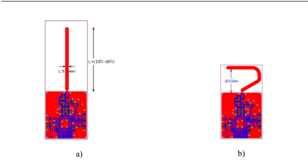

I have some questions about the quaterwave monopole antenna.
In the papers of Nordic I did read:
If the ground plane size is considerably smaller than the ideal size and/or much of the antenna trace is routed close to the edge of the PCB, then the length of the antenna trace should be extended by about 30%. For an example, see Figure 1b.
What is meant with ideal size?
And how much gain do I expect with this type of antenna?
