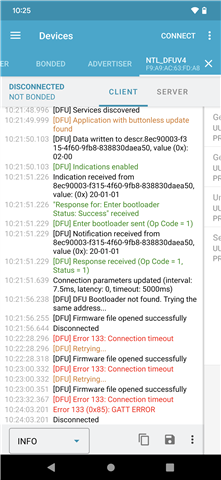

GATT Error issue(Error 133) when DFU Firmware updating through nRFConnect application
followed below link to do the firmware updating using DFU service with "nRF Connec"t application on Android mobile.
https://novelbits.io/nrf52-ota-dfu-ble-part-4/
While updating the Zip file I am getting Error 133 (0x85):GATT Error, please check the below log and video for more information

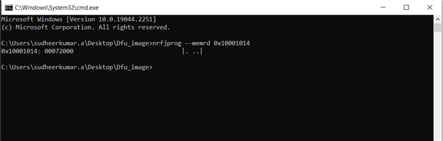

    What application is running on your nRF? Does the log from the nRF say anything particular at the disconnect? They are supposed to disconnect, but the nRF should reboot into DFU mode. Does it do that? If you are using an nRF52833 DK, does two of the leds turn on and remain on (indicating that it is in DFU mode)?
    Did you modify the bootloader in any way? Did you program the bootloader at all?
    If you could share some more details on what's going on on the nRF side, that would be great. The phone application just says that "something is not working".
    Edvin
    Customized application (modified ble_app_uart example)
    No. Custom board with nRF52833, but When I tried  with nRF52833 DK the DFU process is successful.
    Is any changes required for the Custom board to do DFU process?
    modified only public_key.c
    Yes, Merged all boot loader, soft device and application hex files as single Hex and programed through J-Flash lite application
    Sudheer

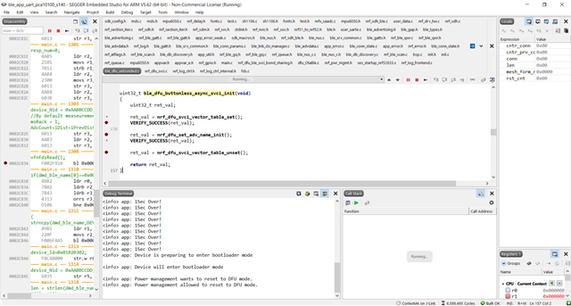

  • Hi Edvin,
    I need your help for  debugging boot loader project,
    When I debug the Bootloader project with custom board, there is no application BLE advertisement on nRF connect app.
    how my application project will run while debugging the bootloader project. Here I don't have any idea about it.
    Is there any procedure for debugging simultaneously boot loader and application project, please let me know
    I am using SES IDE
    Sudheer
    I tried like this for debugging the boot loader project.
    1. open boot loader project, and loaded with the custom board in debug mode
    2. opened J-Flash lite and flashed softdevice
    3. then flashed application hex file with J-Flash lite.
    4. Pressed "Continuous Execution" button in bootloader project (which I loaded in the debug mode)
    After this checked for the BLE device name on nRF connect app. but I am unable to find the My device BLE application name
    please suggest me if the above process is correct or I need to follow any other process to do it.
    Sudheer

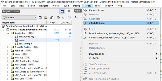

  • Before sending anything, please try to reset the device before you attach the debugger using "Target -> Attach debugger".
    You can use nrfjprog to do so. In fact, you can use nrfjprog to program as well:
    Open a cmd window in SDK\examples\dfu\secure_bootloader\pca10100_s140_ble\ses, and use the following commands:
    nrfjprog -e
    nrfjprog --program
    nrfjprog --program ..\..\..\..\..\components\softdevice\s140\hex\s140_nrf52_7.2.0_softdevice.hex --verify
    nrfjprog --program Output\Release\Exe\secure_bootloader_ble_s140_pca10100.hex --verify
    nrfjprog --reset
    And then attach the debugger, not by pressing "Connect", but "Target" -> "Attach debugger":
    You can also try restarting by using this button:
    What happens if you reset the device and try to attach the debugger?
    Edvin

    I have observed there is 32.768KHz crystal is connected to P0.0 and P0.1 pins on 52833 DK board, but in my custom board no crystal is connected for the P0.0 and P0.1 pins. Is the cause for it.
    If 32.768KHz problem, then without this crystal how to do the DFU. Is there any possibility?
    Sudheer
  • Hello Sudheer,
    I would suppose it should hit the start of main.c.
    Can you try to set the LFCLK settings in sdk_config.h: for your bootloader (and application):
    NRF_SDH_CLOCK_LF_SRC 0
    NRF_SDH_CLOCK_LF_RC_CTIV 16
    NRF_SDH_CLOCK_LF_RC_TEMP_CTIV 2
    NRF_SDH_CLOCK_LF_ACCURACY 1
    Can you please upload your bootloader project (zip the project folder), so that I can check if I have more questions. But is optimization disabled in your bootloader project?
    BR,
    Edvin
  • Hi Edvin,
    Yah!, the above clock source changes worked for me. Now DFU process is working successfully with my custom board.

     0> <info> app: 1Sec Over!
     0> <info> app: Connecting to target F4305B651C7B
     0> <info> app: Connected
     0> <info> app: Connection with link 0x4 established.
     0> <info> app: Data len is set to 0xF4(244)
     0> <info> app: Device is preparing to enter bootloader mode
     0>
     0> <info> app: Device will enter bootloader mode
     0>
     0> <info> app: Power management wants to reset to DFU mode.
     0> <info> app: Power management allowed to reset to DFU mode.
     0> <info> app: Setting vector table to bootloader: 0x00078000
     0> <info> app: Setting vector table to main app: 0x00027000
     0> <info> app_timer: RTC: initialized.

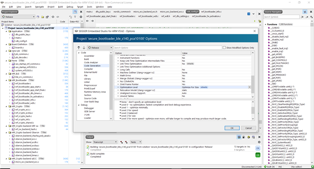

    No, It's "optimize for Size"
    If we keep optimization as "None", can we see more log?
    Sudheer
