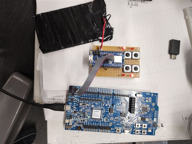

First of all, I have two "nrf52840-dk" and use "SEGGER Embedded Studio" to install the mesh sample "light_switch" (server) to the two "DKs" and use the Android app "nRF Mesh" I checked the operation and it worked fine.
I wanted to build more networks here, so I built an Adafruit Feather nRF52840 Express with 4 switches and 4 LEDs just like the DK. And installed "light_switch" (server) via SWD.
But this didn't work the same as "DK".
Debug Terminal shows the following message:
<t: 0>, main.c, 367, ----- BLE Mesh Light Switch Server Demo -----
<t: 18925>, app_error_weak.c, 105, Mesh assert at 0x0002FC50 (:0)
Are these settings missing?
I have no idea.
    For using nRF5 SDK (and nRF5 SDK for Mesh) projects on custom boards, you will need a board file for the custom board, in order for pin configurations to be correct. See Using the SDK with other boards for details.
    In addition, there might be differences in crystals, oscillators and power source for different boards. For instance, the nRF52840 Dongle needs different settings than the DK, and so for that Dongle we have the nRF52840 Dongle Programming Tutorial. What settings and steps are needed, depend on the particular board.
    Please note also that for new projects we recommend nRF Connect SDK, as nRF5 SDK is now in maintenance mode. See our nRF Connect SDK and nRF5 SDK statement for details. The Adafruit Feather nRF52840 Express seems to be supported already in nRF Connect SDK, through board files in the Zephyr Project. You could try out the Bluetooth: Mesh light sample in nRF Connect SDK, which corresponds to the light switch examples from nRF5 SDK for Mesh.
