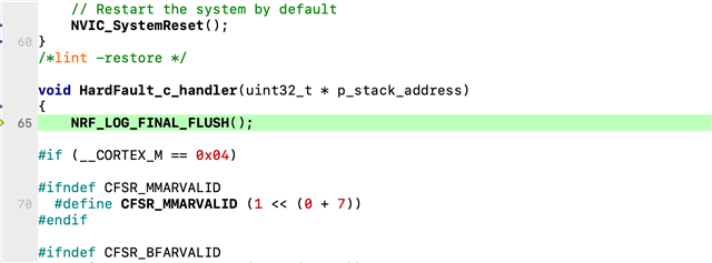

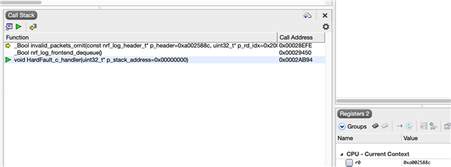

    this is the call stack after attaching a debugger after the DFU
    so I reset the sensor in debug mode, then this crash report appears:
    then I reattached the debugger and this crash report appears
    NRF_LOG is enabled and RTT is enabled on both.
    does this help?

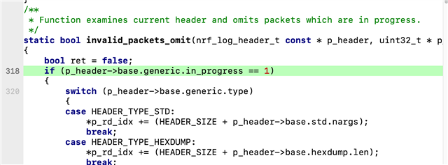

    I cant see whats going on in that advertising function, it crashes at this handler:
    When you write "crashes", what exactly do that mean? Can you elaborate? What do you find about the state of the device and what happened from debugging? And what do you see form the RTT log?
