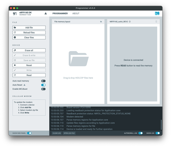

I connect nrfr52840 dk to pc and connect debug out to fanstel BWG832F module . Fanstel module is powered. Code flash by using nrf connect for dekstop.
In the Programmer app of nRF Connect for Desktop, what device is visible in the right hand side "window":
In the image above I'm using the nRF9160DK to read a device from a custom board, in this case another nRF9160. It should show nRF52832 on your side.
