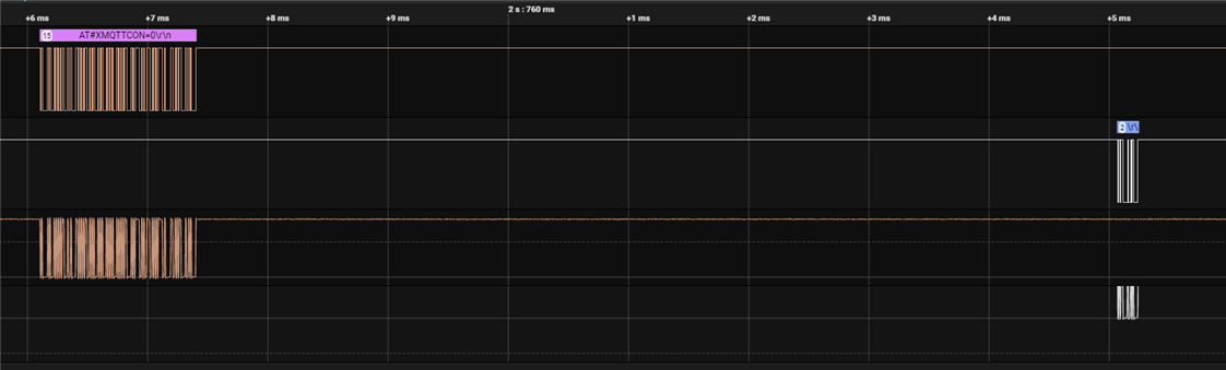

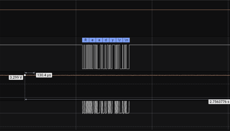

  • Hi ,
    I reproduced the problem with MQTT Disconnect on the evaluation board (SDK 2.1.2 + Native TLS).
    I have attached the RTT and Link monitor logs.
    nRF9160 reboot every time when I try to disconnect from the AWS broker.

    2022-12-18T12:39:11.960Z DEBUG modem >> AT#XMQTTCON=1,"AR999SZ00043","","","a34k7wa09ujucc-ats.iot.us-east-1.amazonaws.com",8883,321
    2022-12-18T12:39:12.962Z ERROR Error: 'AT#XMQTTCON=1,"AR999SZ00043","","","a34k7wa09ujucc-ats.iot.us-east-1.amazonaws.com",8883,321
    ' timed out
    2022-12-18T12:39:15.039Z DEBUG modem << OK
    2022-12-18T12:39:15.353Z DEBUG modem << #XMQTTEVT: 0,0
    2022-12-18T12:39:22.768Z DEBUG modem >> AT#XMQTTCON=0
    2022-12-18T12:39:23.998Z DEBUG modem << Ready

    2022-12-18T12:40:48.455Z DEBUG modem >> AT#XMQTTCON=0
    2022-12-18T12:40:49.690Z DEBUG modem << Ready
    00> *** Booting Zephyr OS build v3.1.99-ncs1-1  ***

  • Hi ,
    This seems to be reset of some sort based on the description. This is not visible in the logs you have provided, other than "Ready" is returned after MQTT disconnect.
    If we use the logic analyzer to view TX/RX from UART, sometimes we saw different results after executing the broker disconnect command.
    Sometimes it's just line breaks (\r\n), and sometimes it's an illogical set of characters before getting "Ready".
