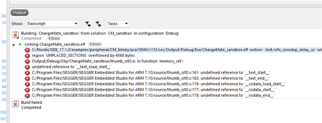

I'm trying to get blinky to build using SES. It would be great if I could start with an example that builds and work from there, but apparently you guys don't have such a thing. So I copied the blinky project to a new folder and tried a build. Just as with the original blinky, I get an error concerning the .text and .rodata tags in the flash_placement.xml file:
So I remove those lines from the flash_placement and try to build again. It fails with a whole new set of errors:

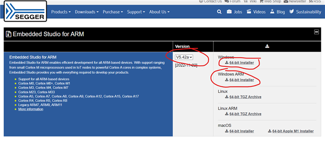

    So I went to the Segger download site and selected version 5.42a like so:
    Note that there are two similar links. It turns out they both download slightly different versions of SES 7.10.
    In both links, the file that was downloaded was the version 7.10 installer, not the 5.42a installer. Either Segger has an error on their download site or the old 5.42a version is no longer available.
    Where did you get SES version 5.42a? Do you have an installer for it?
    Note that this DK does not work with VS Code so I must get SES to work. Can you get an expert involved so we can solve this?
  • I just sent a support ticket to Segger about their website, hoping to find the 5.42a installer. But, just in case 5.42a is no longer available, does your team have an installer for that version?

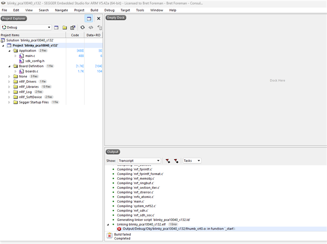

  • I got a reply from Segger and they sent me a link to download SES version 5.42a directly. Here's a screenshot of my about screen:
    I tried to build blinky with this version of SES and got the following error:
    Can you tell me how to clear this error?
  • It looks like the linker is trying to link in the thumb_crt0.o object from a previous build with SES 7. A full rebuild should do the trick in that case. If not, you can delete the 'Output' folder in your project directory before you try again.
