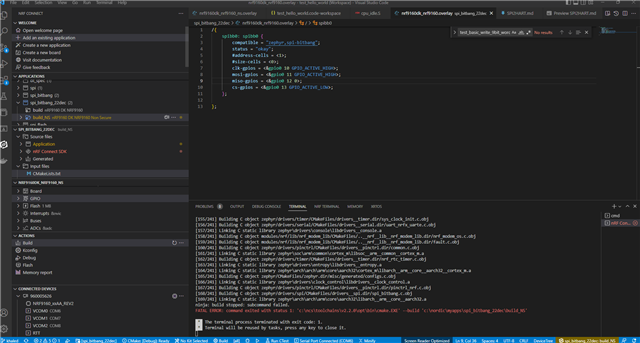

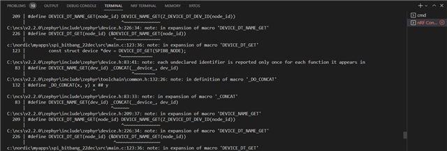

SPI error: FATAL ERROR: command exited with status 1:
I'm trying to connect to SPI modem and I did tried tons of solutions, nothing worked or even passed the build stage.
can you guide me how I can at least see what's the error? the only error i get for all examples is similar to this.
FATAL ERROR: command exited with status 1: 'c:\ncs\toolchains\v2.2.0\opt\bin\cmake.EXE' --build 'c:\SecureGatewayGen3\khaled\espi\build'
Thank you

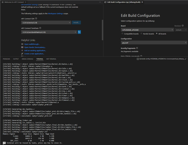

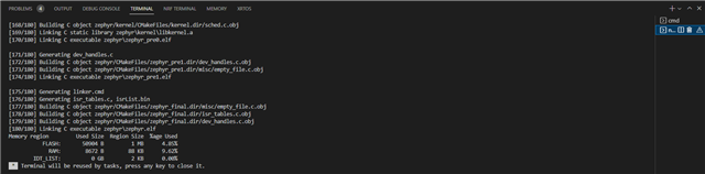

  • Hi Khaled,
    Can you check the complete log for what error you are getting?
    Meanwhile, can you try the following:

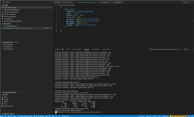

    Extract the attached zip file and place the folder spi_bitbang_jan5 in c:/ncs/myworkfile/
    spi_bitbang_jan5.rar
    And then after opening with the VS code, do the pristine build.
    Image below is showing the NCS and Toolchain version and the successful build.
    Naeem

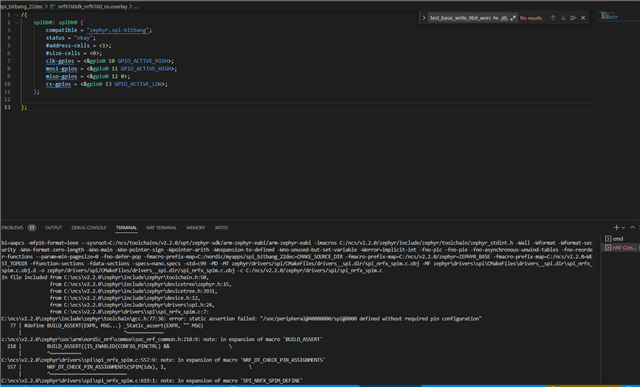

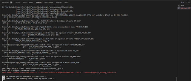

  • [152/241] Building C object zephyr/CMakeFiles/zephyr.dir/soc/arm/nordic_nrf/validate_enabled_instances.c.obj
    FAILED: zephyr/CMakeFiles/zephyr.dir/soc/arm/nordic_nrf/validate_enabled_instances.c.obj
    C:\ncs\toolchains\v2.2.0\opt\zephyr-sdk\arm-zephyr-eabi\bin\arm-zephyr-eabi-gcc.exe -DKERNEL -DMBEDTLS_CONFIG_FILE=\"nrf-config.h\" -DMBEDTLS_USER_CONFIG_FILE=\"nrf-config-user.h\" -DNRF9160_XXAA -DNRF_SKIP_FICR_NS_COPY_TO_RAM -DNRF_TRUSTZONE_NONSECURE -DUSE_PARTITION_MANAGER=1 -D_ANSI_SOURCE -D_FORTIFY_SOURCE=1 -D__LINUX_ERRNO_EXTENSIONS__ -D__PROGRAM_START -D__ZEPHYR__=1 -IC:/ncs/v2.2.0/zephyr/kernel/include -IC:/ncs/v2.2.0/zephyr/arch/arm/include -Itfm/install/interface/include -IC:/ncs/v2.2.0/zephyr/include -Izephyr/include/generated -IC:/ncs/v2.2.0/zephyr/soc/arm/nordic_nrf/nrf91 -IC:/ncs/v2.2.0/zephyr/lib/libc/newlib/include -IC:/ncs/v2.2.0/zephyr/soc/arm/nordic_nrf/common/. -IC:/ncs/v2.2.0/nrf/include -IC:/ncs/v2.2.0/nrf/include/tfm -IC:/ncs/v2.2.0/nrf/tests/include -Itfm/generated/interface/include -IC:/ncs/v2.2.0/modules/hal/cmsis/CMSIS/Core/Include -IC:/ncs/v2.2.0/modules/hal/nordic/nrfx -IC:/ncs/v2.2.0/modules/hal/nordic/nrfx/drivers/include -IC:/ncs/v2.2.0/modules/hal/nordic/nrfx/mdk -IC:/ncs/v2.2.0/zephyr/modules/hal_nordic/nrfx/. -IC:/ncs/v2.2.0/nrfxlib/nrf_modem/include -Imodules/nrfxlib/nrfxlib/nrf_security/src/include/generated -IC:/ncs/v2.2.0/nrfxlib/nrf_security/include -IC:/ncs/v2.2.0/nrfxlib/nrf_security/include/mbedtls -IC:/ncs/v2.2.0/mbedtls/include -IC:/ncs/v2.2.0/mbedtls/include/mbedtls -IC:/ncs/v2.2.0/mbedtls/include/psa -IC:/ncs/v2.2.0/mbedtls/library -IC:/ncs/v2.2.0/nrfxlib/crypto/nrf_oberon/include/mbedtls -IC:/ncs/v2.2.0/nrfxlib/crypto/nrf_oberon/include -fno-strict-aliasing -Os -imacros C:/app/spi_bitbang_jan5/build_ns/zephyr/include/generated/autoconf.h -ffreestanding -fno-common -g -gdwarf-4 -fdiagnostics-color=always -mcpu=cortex-m33 -mthumb -mabi=aapcs -mfp16-format=ieee --sysroot=C:/ncs/toolchains/v2.2.0/opt/zephyr-sdk/arm-zephyr-eabi/arm-zephyr-eabi -imacros C:/ncs/v2.2.0/zephyr/include/zephyr/toolchain/zephyr_stdint.h -Wall -Wformat -Wformat-security -Wno-format-zero-length -Wno-main -Wno-pointer-sign -Wpointer-arith -Wexpansion-to-defined -Wno-unused-but-set-variable -Werror=implicit-int -fno-pic -fno-pie -fno-asynchronous-unwind-tables -fno-reorder-functions --param=min-pagesize=0 -fno-defer-pop -fmacro-prefix-map=C:/app/spi_bitbang_jan5=CMAKE_SOURCE_DIR -fmacro-prefix-map=C:/ncs/v2.2.0/zephyr=ZEPHYR_BASE -fmacro-prefix-map=C:/ncs/v2.2.0=WEST_TOPDIR -ffunction-sections -fdata-sections -specs=nano.specs -std=c99 -MD -MT zephyr/CMakeFiles/zephyr.dir/soc/arm/nordic_nrf/validate_enabled_instances.c.obj -MF zephyr\CMakeFiles\zephyr.dir\soc\arm\nordic_nrf\validate_enabled_instances.c.obj.d -o zephyr/CMakeFiles/zephyr.dir/soc/arm/nordic_nrf/validate_enabled_instances.c.obj -c C:/ncs/v2.2.0/zephyr/soc/arm/nordic_nrf/validate_enabled_instances.c
    In file included from C:\ncs\v2.2.0\zephyr\include\zephyr\toolchain.h:50,
                     from C:\ncs\v2.2.0\zephyr\include\zephyr\kernel_includes.h:19,
                     from C:\ncs\v2.2.0\zephyr\include\zephyr\kernel.h:17,
                     from C:\ncs\v2.2.0\zephyr\soc\arm\nordic_nrf\validate_enabled_instances.c:7:
    C:\ncs\v2.2.0\zephyr\include\zephyr\toolchain\gcc.h:77:36: error: static assertion failed: "Only one of the following peripherals can be enabled: SPI0, SPIM0, SPIS0, TWI0, TWIM0, TWIS0, UARTE0. Check nodes with status \"okay\" in zephyr.dts."
       77 | #define BUILD_ASSERT(EXPR, MSG...) _Static_assert(EXPR, "" MSG)
    C:\ncs\v2.2.0\zephyr\soc\arm\nordic_nrf\validate_enabled_instances.c:48:1: note: in expansion of macro 'BUILD_ASSERT'
       48 | BUILD_ASSERT(CHECK(0), MSG(0));
    [153/241] Building C object zephyr/drivers/entropy/CMakeFiles/drivers__entropy.dir/C_/ncs/v2.2.0/nrf/drivers/entropy/entropy_cc3xx.c.obj
    [154/241] Building C object zephyr/drivers/serial/CMakeFiles/drivers__serial.dir/uart_nrfx_uarte.c.obj
    [155/241] Building C object modules/nrf/modules/tfm/zephyr/CMakeFiles/tfm_api_nrf.dir/__/tfm/boards/src/tfm_ioctl_ns_api.c.obj
    [156/241] Building C object zephyr/drivers/timer/CMakeFiles/drivers__timer.dir/sys_clock_init.c.obj
    [157/241] Building C object zephyr/drivers/timer/CMakeFiles/drivers__timer.dir/nrf_rtc_timer.c.obj
    [158/241] Building C object zephyr/drivers/pinctrl/CMakeFiles/drivers__pinctrl.dir/pinctrl_nrf.c.obj
    [159/241] Building C object zephyr/drivers/pinctrl/CMakeFiles/drivers__pinctrl.dir/common.c.obj
    [160/241] Building C object modules/nrf/lib/nrf_modem_lib/CMakeFiles/..__nrf__lib__nrf_modem_lib.dir/nrf_modem_lib.c.obj
    [161/241] Building C object modules/nrf/lib/nrf_modem_lib/CMakeFiles/..__nrf__lib__nrf_modem_lib.dir/sanity.c.obj
    [162/241] Building C object modules/nrf/lib/nrf_modem_lib/CMakeFiles/..__nrf__lib__nrf_modem_lib.dir/fault.c.obj
    [163/241] Building C object modules/nrf/lib/nrf_modem_lib/CMakeFiles/..__nrf__lib__nrf_modem_lib.dir/nrf_modem_os.c.obj
    [164/241] Building C object zephyr/drivers/spi/CMakeFiles/drivers__spi.dir/spi_nrfx_spim.c.obj
    FAILED: zephyr/drivers/spi/CMakeFiles/drivers__spi.dir/spi_nrfx_spim.c.obj
    C:\ncs\toolchains\v2.2.0\opt\zephyr-sdk\arm-zephyr-eabi\bin\arm-zephyr-eabi-gcc.exe -DKERNEL -DMBEDTLS_CONFIG_FILE=\"nrf-config.h\" -DMBEDTLS_USER_CONFIG_FILE=\"nrf-config-user.h\" -DNRF9160_XXAA -DNRF_SKIP_FICR_NS_COPY_TO_RAM -DNRF_TRUSTZONE_NONSECURE -DUSE_PARTITION_MANAGER=1 -D_ANSI_SOURCE -D_FORTIFY_SOURCE=1 -D__LINUX_ERRNO_EXTENSIONS__ -D__PROGRAM_START -D__ZEPHYR_SUPERVISOR__ -D__ZEPHYR__=1 -IC:/ncs/v2.2.0/zephyr/include -Izephyr/include/generated -IC:/ncs/v2.2.0/zephyr/soc/arm/nordic_nrf/nrf91 -IC:/ncs/v2.2.0/zephyr/lib/libc/newlib/include -IC:/ncs/v2.2.0/zephyr/soc/arm/nordic_nrf/common/. -IC:/ncs/v2.2.0/nrf/include -IC:/ncs/v2.2.0/nrf/include/tfm -IC:/ncs/v2.2.0/nrf/tests/include -Itfm/generated/interface/include -IC:/ncs/v2.2.0/modules/hal/cmsis/CMSIS/Core/Include -IC:/ncs/v2.2.0/modules/hal/nordic/nrfx -IC:/ncs/v2.2.0/modules/hal/nordic/nrfx/drivers/include -IC:/ncs/v2.2.0/modules/hal/nordic/nrfx/mdk -IC:/ncs/v2.2.0/zephyr/modules/hal_nordic/nrfx/. -IC:/ncs/v2.2.0/nrfxlib/nrf_modem/include -Itfm/install/interface/include -Imodules/nrfxlib/nrfxlib/nrf_security/src/include/generated -IC:/ncs/v2.2.0/nrfxlib/nrf_security/include -IC:/ncs/v2.2.0/nrfxlib/nrf_security/include/mbedtls -IC:/ncs/v2.2.0/mbedtls/include -IC:/ncs/v2.2.0/mbedtls/include/mbedtls -IC:/ncs/v2.2.0/mbedtls/include/psa -IC:/ncs/v2.2.0/mbedtls/library -IC:/ncs/v2.2.0/nrfxlib/crypto/nrf_oberon/include/mbedtls -IC:/ncs/v2.2.0/nrfxlib/crypto/nrf_oberon/include -fno-strict-aliasing -Os -imacros C:/app/spi_bitbang_jan5/build_ns/zephyr/include/generated/autoconf.h -ffreestanding -fno-common -g -gdwarf-4 -fdiagnostics-color=always -mcpu=cortex-m33 -mthumb -mabi=aapcs -mfp16-format=ieee --sysroot=C:/ncs/toolchains/v2.2.0/opt/zephyr-sdk/arm-zephyr-eabi/arm-zephyr-eabi -imacros C:/ncs/v2.2.0/zephyr/include/zephyr/toolchain/zephyr_stdint.h -Wall -Wformat -Wformat-security -Wno-format-zero-length -Wno-main -Wno-pointer-sign -Wpointer-arith -Wexpansion-to-defined -Wno-unused-but-set-variable -Werror=implicit-int -fno-pic -fno-pie -fno-asynchronous-unwind-tables -fno-reorder-functions --param=min-pagesize=0 -fno-defer-pop -fmacro-prefix-map=C:/app/spi_bitbang_jan5=CMAKE_SOURCE_DIR -fmacro-prefix-map=C:/ncs/v2.2.0/zephyr=ZEPHYR_BASE -fmacro-prefix-map=C:/ncs/v2.2.0=WEST_TOPDIR -ffunction-sections -fdata-sections -specs=nano.specs -std=c99 -MD -MT zephyr/drivers/spi/CMakeFiles/drivers__spi.dir/spi_nrfx_spim.c.obj -MF zephyr\drivers\spi\CMakeFiles\drivers__spi.dir\spi_nrfx_spim.c.obj.d -o zephyr/drivers/spi/CMakeFiles/drivers__spi.dir/spi_nrfx_spim.c.obj -c C:/ncs/v2.2.0/zephyr/drivers/spi/spi_nrfx_spim.c
                     from C:\ncs\v2.2.0\zephyr\include\zephyr\devicetree\zephyr.h:15,
                     from C:\ncs\v2.2.0\zephyr\include\zephyr\devicetree.h:3931,
                     from C:\ncs\v2.2.0\zephyr\include\zephyr\device.h:12,
                     from C:\ncs\v2.2.0\zephyr\include\zephyr\drivers\spi.h:24,
                     from C:\ncs\v2.2.0\zephyr\drivers\spi\spi_nrfx_spim.c:7:
    C:\ncs\v2.2.0\zephyr\include\zephyr\toolchain\gcc.h:77:36: error: static assertion failed: "/soc/peripheral@40000000/spi@8000 defined without required pin configuration"
    c:\ncs\v2.2.0\zephyr\soc\arm\nordic_nrf\common\soc_nrf_common.h:218:9: note: in expansion of macro 'BUILD_ASSERT'
      218 |         BUILD_ASSERT((IS_ENABLED(CONFIG_PINCTRL) &&                     \
    C:\ncs\v2.2.0\zephyr\drivers\spi\spi_nrfx_spim.c:557:9: note: in expansion of macro 'NRF_DT_CHECK_PIN_ASSIGNMENTS'
      557 |         NRF_DT_CHECK_PIN_ASSIGNMENTS(SPIM(idx), 1,                             \
    C:\ncs\v2.2.0\zephyr\drivers\spi\spi_nrfx_spim.c:619:1: note: in expansion of macro 'SPI_NRFX_SPIM_DEFINE'
      619 | SPI_NRFX_SPIM_DEFINE(0);
    C:\ncs\v2.2.0\zephyr\include\zephyr\toolchain\gcc.h:77:36: error: static assertion failed: "/soc/peripheral@40000000/spi@8000 has legacy *-pin properties defined although PINCTRL is enabled"
    c:\ncs\v2.2.0\zephyr\soc\arm\nordic_nrf\common\soc_nrf_common.h:229:9: note: in expansion of macro 'BUILD_ASSERT'
      229 |         BUILD_ASSERT(!IS_ENABLED(CONFIG_PINCTRL) ||                     \

    FATAL ERROR: command exited with status 1: 'c:\ncs\toolchains\v2.2.0\opt\bin\cmake.EXE' --build 'c:\app\spi_bitbang_jan5\build_ns'
    This is the full error when I tried to build your last file spi_bitbang_jan5.rar
    [157/241] Building C object zephyr/drivers/pinctrl/CMakeFiles/drivers__pinctrl.dir/common.c.obj
    [159/241] Building C object modules/nrf/lib/nrf_modem_lib/CMakeFiles/..__nrf__lib__nrf_modem_lib.dir/nrf_modem_os.c.obj
    [160/241] Building C object modules/nrf/lib/nrf_modem_lib/CMakeFiles/..__nrf__lib__nrf_modem_lib.dir/sanity.c.obj
    [161/241] Building C object modules/nrf/lib/nrf_modem_lib/CMakeFiles/..__nrf__lib__nrf_modem_lib.dir/fault.c.obj
    [162/241] Building C object modules/nrf/lib/nrf_modem_lib/CMakeFiles/..__nrf__lib__nrf_modem_lib.dir/nrf_modem_lib.c.obj
    [163/241] Building C object zephyr/drivers/spi/CMakeFiles/drivers__spi.dir/spi_nrfx_spim.c.obj
    [164/241] Linking C static library zephyr\subsys\random\libsubsys__random.a
    [165/241] Building C object modules/nrf/lib/modem_antenna/CMakeFiles/..__nrf__lib__modem_antenna.dir/modem_antenna.c.obj
    [166/241] Linking C static library zephyr\arch\arch\arm\core\aarch32\mpu\libarch__arm__core__aarch32__mpu.a
    [167/241] Building C object modules/trusted-firmware-m/CMakeFiles/tfm_api.dir/interface/interface.c.obj
    [168/241] Linking C static library zephyr\boards\arm\nrf9160dk_nrf9160\libboards__arm__nrf9160dk_nrf9160.a
    [169/241] Building C object zephyr/drivers/timer/CMakeFiles/drivers__timer.dir/nrf_rtc_timer.c.obj
    [170/241] Linking C static library zephyr\drivers\entropy\libdrivers__entropy.a
    [171/241] Building C object modules/trusted-firmware-m/CMakeFiles/tfm_api.dir/src/zephyr_tfm_log.c.obj
    [172/241] Linking C static library zephyr\drivers\gpio\libdrivers__gpio.a
    [173/241] Building C object modules/nrf/lib/fatal_error/CMakeFiles/..__nrf__lib__fatal_error.dir/fatal_error.c.obj
    [174/241] Linking C static library zephyr\drivers\serial\libdrivers__serial.a
    [175/241] Building C object modules/trusted-firmware-m/CMakeFiles/tfm_api.dir/__/__/tfm/install/interface/src/tfm_platform_ipc_api.c.obj
    [176/241] Linking C static library zephyr\lib\libc\newlib\liblib__libc__newlib.a
    [177/241] Linking C static library zephyr\drivers\clock_control\libdrivers__clock_control.a
    [178/241] Linking C static library zephyr\soc\arm\common\cortex_m\libsoc__arm__common__cortex_m.a
    [179/241] Linking C static library zephyr\drivers\console\libdrivers__console.a
