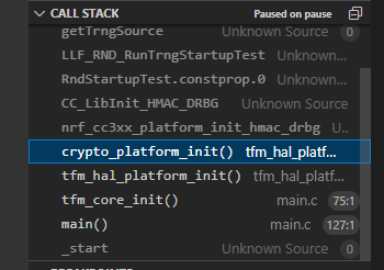

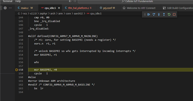

The debugger runs and is running. It does not break at main(). If I click Pause, it is usually here:
It may be getting stuck in some sort of bootloader image validation. Sometimes if I pause, it is in checks in a function called main that is not my main:

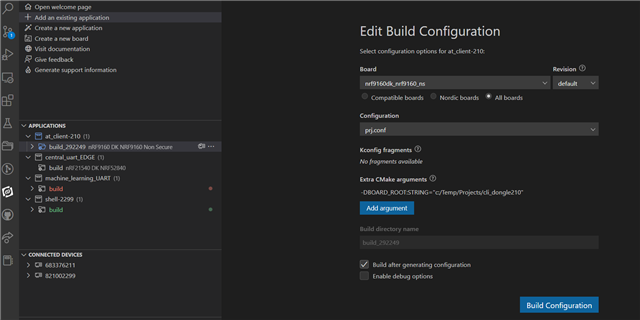

  • Instructions I am referring to are the standard instructions to build and flash with VSCode.
    An example, I am trying to run this lesson exercise:
    https://academy.nordicsemi.com/topic/lesson-2-exercise-1/
    Which links to the instructions:
    https://nrfconnect.github.io/vscode-nrf-connect/get_started/build_app_ncs.html
    https://nrfconnect.github.io/vscode-nrf-connect/get_started/quick_debug.html
    Those are the instructions I am following to build and flash, and the only instructions I am aware of.
    The pre-compiled examples all work fine. I flash those with Connect for Desktop Programmer app, or J-flash lite, and they work great.
    When I flash the nRF9160 from VSCode with compiled examples, I get to the debug output above, but nothing on the serial ports.
    The Serial ports are still there, so the nRF52 Connectivity Bridge is fine, and yes, my switch is on nRF91.
    Could you please find out what could cause the nrf91 code to not run to main, but the pre-comipled examples to work?
  • Ah, glad you were able to replicate the issue! It sounds to me like my build process is messing something up.
    I am using nRF SDK v2.2.0 from nRF Connect for Desktop, on Windows 10. I used the toolchain to install it to C:\ncs\v2.2.0.
    Then, I open VSCode from toolchain  Manager, this gives me the Nrf connect welcome screen.
    I just followed the instructions described above to build and flash. For the build, I choose "thingy91_nrf9160_ns". I have tried without the ns, and also tried checking the box "Enable debug options", with the same outcome: stuck in that crypto_platform_init.

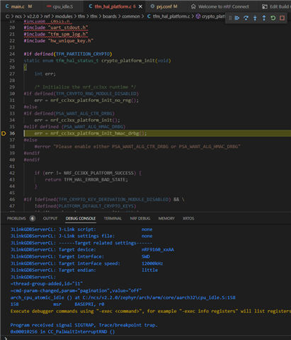

    I just tried the lesson 2 exercise 2 instructions here:
    https://academy.nordicsemi.com/topic/lesson-2-exercise-2/

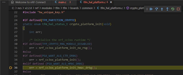

    and got the same result. No Link Manager access, and if I debug, it starts here:
    Then, when I click Play, nothing comes up on the COM ports. If I click Pause:

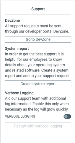

    Yes, there seems to be an issue on your side. Can you please provide the output from the VS Code command (SHIFT+CTRL+i) "nRF Connect: Generate Support information"?
  • Ok, the hotkey didn't work for me, but I went to the nRF Connect extension and clicked on Generate Support Information.

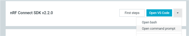

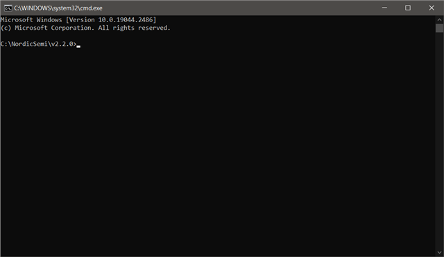

  • Thank you for providing this information!

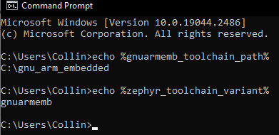

    Looking through your support information and comparing to mine I see that you do not have GNUARMEMB_TOOLCHAIN_PATH set.
    How did you install the SDK? Are you using the toolchain manager?
  • Yes, sorry I wasn't clearer before. I installed everything via nRF Connect for Desktop. First I installed nRF connect, then the "Toolchain Manager", then followed its link to install VSCode, while installing toolchain 2.2.0, then opened VSCode and everything looks as it should in the examples to add and build code.
    I didn't change or add anything custom. I have some older path entries (as you can see!) to other compilers, etc, but I followed the instructions exactly to set up the IDE and Toolchain.
    I will try adding that path entry. Is that the only thing I am missing? I expected your instructions to work, and have not modified my install process at all.

  • Ok, I have now followed the instructions on the page you linked, and I have added to my System PATH:
    I get a similar result when debugging. This is where it was when I paused after 5 minutes of running a debug session:

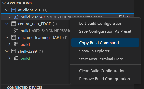

    If you are using the Toolchain Manager it should fix everything for you. There should not be a reason to set the GNUARMEMB toolchain path.
    Is this your personal computer or business computer, i.e. are there any administrative rights needed? Did you install using VPN? Would it be possible to reinstall the nRF Connect SDK in the Toolchain Manager with Verbose Logging enabled under About:
    Collin Moore said:
    What am I missing? Can you please point me to more complete instructions, or a path to getting working on Windows 10?
    I'm really not seeing the reason for this either. What does your build configuration for the board look like?
    And what does the build command look like in VS code
    Here is mine
    west build --build-dir c:\Temp\Projects\at_client-210\build_292249 c:\Temp\Projects\at_client-210 --pristine --board nrf9160dk_nrf9160_ns -- -DNCS_TOOLCHAIN_VERSION:STRING="NONE" -DBOARD_ROOT:STRING="c:/Temp/Projects/shell-2299;c:/Temp/Projects/cli_dongle210" -DCONF_FILE:STRING="c:/Temp/Projects/at_client-210/prj.conf"
    I want to you try one last thing. In the Toolchain manager open Bash or Command Prompt
    This will open an instance of CMD or Git Bash, with all settings configured by Toolchain Manager.
    From here navigate to at_client (or other samples) e.g. cd nrf\samples\nrf9160\at_client
    Here you could try to build the sample using west build
    west build -b thingy91_nrf9160_ns -d build_300534
    This is exactly what VS code does as well, but interesting to see if does change anything.
  • Hey, thanks for the reply!
    I only ever used toolchain manager. Both computers are my personal computer, on normal network, home router, no VPNs, with Administrator Windows 10 accounts.
    The toolchain takes a while to download, but I'll do that after I try what you suggested. I'll upload the verbose log in a bit.
    Right now, when I right-click Copy Build Configuration:
    west build --build-dir c:\C-IoT-Fund\Cellular-IoT-Fundamentals\lesson2\cellfund_less2_exer2\build c:\C-IoT-Fund\Cellular-IoT-Fundamentals\lesson2\cellfund_less2_exer2 --pristine --board thingy91_nrf9160_ns -- -DNCS_TOOLCHAIN_VERSION:STRING="NONE" -DCONF_FILE:STRING="c:/C-IoT-Fund/Cellular-IoT-Fundamentals/lesson2/cellfund_less2_exer2/prj.conf"
    I don't have a DBOARD_ROOT entry, or numbers after build, but other than that it looks pretty similar to me.
    Next, I tried Cleaning the Build config:
     *  Executing task: nRF Connect: Build [clean]: cellfund_less2_exer2/build (active)
    Building cellfund_less2_exer2
    west build -t clean --build-dir c:\C-IoT-Fund\Cellular-IoT-Fundamentals\lesson2\cellfund_less2_exer2\build
    -- west build: running target clean
    [1/2] Cleaning additional files...
    [2/2] Cleaning all built files...
    Cleaning... 6 files.

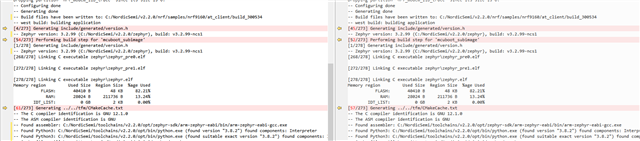

    Build looked successful, but the terminal lost the text from the beginning:
    Next I opened Command Prompt from the Toolchain Manager drop-down, cd into at_client and built it. here is the beginning:

    [166/278] Linking C static library zephyr\drivers\gpio\libdrivers__gpio.a
    [167/278] Building C object modules/mbedtls/CMakeFiles/modules__mbedtls.dir/zephyr_init.c.obj
    [168/278] Linking C static library zephyr\drivers\flash\libdrivers__flash.a
    [169/278] Linking C static library zephyr\drivers\serial\libdrivers__serial.a
    [170/278] Building C object modules/mbedtls/CMakeFiles/modules__mbedtls.dir/C_/ncs/v2.2.0/modules/crypto/mbedtls/library/aria.c.obj
    [171/278] Linking C static library modules\nrf\drivers\hw_cc310\lib..__nrf__drivers__hw_cc310.a
    [172/278] Linking C static library zephyr\drivers\pinctrl\libdrivers__pinctrl.a
    [173/278] Building C object modules/mbedtls/CMakeFiles/modules__mbedtls.dir/C_/ncs/v2.2.0/modules/crypto/mbedtls/library/aesni.c.obj
    [174/278] Linking C static library zephyr\drivers\timer\libdrivers__timer.a
    [175/278] Building C object modules/mbedtls/CMakeFiles/modules__mbedtls.dir/C_/ncs/v2.2.0/modules/crypto/mbedtls/library/ccm.c.obj
    [176/278] Building C object modules/mbedtls/CMakeFiles/modules__mbedtls.dir/C_/ncs/v2.2.0/modules/crypto/mbedtls/library/asn1parse.c.obj
    [177/278] Building C object modules/mbedtls/CMakeFiles/modules__mbedtls.dir/C_/ncs/v2.2.0/modules/crypto/mbedtls/library/chacha20.c.obj
    [178/278] Building C object modules/mbedtls/CMakeFiles/modules__mbedtls.dir/C_/ncs/v2.2.0/modules/crypto/mbedtls/library/asn1write.c.obj
    [179/278] Building C object modules/mbedtls/CMakeFiles/modules__mbedtls.dir/C_/ncs/v2.2.0/modules/crypto/mbedtls/library/camellia.c.obj
    [180/278] Building C object modules/mbedtls/CMakeFiles/modules__mbedtls.dir/C_/ncs/v2.2.0/modules/crypto/mbedtls/library/cmac.c.obj
    [181/278] Building C object modules/mbedtls/CMakeFiles/modules__mbedtls.dir/C_/ncs/v2.2.0/modules/crypto/mbedtls/library/cipher_wrap.c.obj
    [182/278] Building C object modules/mbedtls/CMakeFiles/modules__mbedtls.dir/C_/ncs/v2.2.0/modules/crypto/mbedtls/library/base64.c.obj
    [183/278] Building C object modules/mbedtls/CMakeFiles/modules__mbedtls.dir/C_/ncs/v2.2.0/modules/crypto/mbedtls/library/cipher.c.obj
    [184/278] Building C object modules/mbedtls/CMakeFiles/modules__mbedtls.dir/C_/ncs/v2.2.0/modules/crypto/mbedtls/library/aes.c.obj
    [185/278] Building C object modules/mbedtls/CMakeFiles/modules__mbedtls.dir/C_/ncs/v2.2.0/modules/crypto/mbedtls/library/chachapoly.c.obj
    [186/278] Building C object modules/mbedtls/CMakeFiles/modules__mbedtls.dir/C_/ncs/v2.2.0/modules/crypto/mbedtls/library/des.c.obj
    [187/278] Building C object modules/mcuboot/boot/bootutil/zephyr/CMakeFiles/mcuboot_util.dir/C_/ncs/v2.2.0/bootloader/mcuboot/boot/bootutil/src/bootutil_public.c.obj
    [188/278] Building C object modules/mbedtls/CMakeFiles/modules__mbedtls.dir/C_/ncs/v2.2.0/modules/crypto/mbedtls/library/ctr_drbg.c.obj
    [189/278] Building C object modules/mbedtls/CMakeFiles/modules__mbedtls.dir/C_/ncs/v2.2.0/modules/crypto/mbedtls/library/debug.c.obj
    [190/278] Building C object modules/mbedtls/CMakeFiles/modules__mbedtls.dir/C_/ncs/v2.2.0/modules/crypto/mbedtls/library/ecdsa.c.obj
    [191/278] Building C object modules/mbedtls/CMakeFiles/modules__mbedtls.dir/C_/ncs/v2.2.0/modules/crypto/mbedtls/library/dhm.c.obj
    [192/278] Building C object modules/mbedtls/CMakeFiles/modules__mbedtls.dir/C_/ncs/v2.2.0/modules/crypto/mbedtls/library/ecdh.c.obj
    [193/278] Building C object modules/mbedtls/CMakeFiles/modules__mbedtls.dir/C_/ncs/v2.2.0/modules/crypto/mbedtls/library/constant_time.c.obj
    [194/278] Building C object modules/mbedtls/CMakeFiles/modules__mbedtls.dir/C_/ncs/v2.2.0/modules/crypto/mbedtls/library/entropy_poll.c.obj
    [195/278] Building C object modules/mbedtls/CMakeFiles/modules__mbedtls.dir/C_/ncs/v2.2.0/modules/crypto/mbedtls/library/ecp.c.obj
    [196/278] Building C object modules/mbedtls/CMakeFiles/modules__mbedtls.dir/C_/ncs/v2.2.0/modules/crypto/mbedtls/library/ecp_curves.c.obj
    [197/278] Building C object modules/mbedtls/CMakeFiles/modules__mbedtls.dir/C_/ncs/v2.2.0/modules/crypto/mbedtls/library/entropy.c.obj
    [198/278] Building C object modules/mbedtls/CMakeFiles/modules__mbedtls.dir/C_/ncs/v2.2.0/modules/crypto/mbedtls/library/hkdf.c.obj
    [199/278] Building C object modules/mbedtls/CMakeFiles/modules__mbedtls.dir/C_/ncs/v2.2.0/modules/crypto/mbedtls/library/ecjpake.c.obj
    [200/278] Building C object modules/mbedtls/CMakeFiles/modules__mbedtls.dir/C_/ncs/v2.2.0/modules/crypto/mbedtls/library/gcm.c.obj
    [201/278] Building C object modules/mbedtls/CMakeFiles/modules__mbedtls.dir/C_/ncs/v2.2.0/modules/crypto/mbedtls/library/error.c.obj
    [202/278] Building C object modules/mbedtls/CMakeFiles/modules__mbedtls.dir/C_/ncs/v2.2.0/modules/crypto/mbedtls/library/hmac_drbg.c.obj
    [203/278] Linking C static library modules\mcuboot\boot\bootutil\zephyr\libmcuboot_util.a
    [204/278] Building C object modules/mbedtls/CMakeFiles/modules__mbedtls.dir/C_/ncs/v2.2.0/modules/crypto/mbedtls/library/padlock.c.obj
    [205/278] Building C object modules/mbedtls/CMakeFiles/modules__mbedtls.dir/C_/ncs/v2.2.0/modules/crypto/mbedtls/library/md.c.obj
    [206/278] Building C object modules/mbedtls/CMakeFiles/modules__mbedtls.dir/C_/ncs/v2.2.0/modules/crypto/mbedtls/library/mps_reader.c.obj
    [207/278] Building C object modules/mbedtls/CMakeFiles/modules__mbedtls.dir/C_/ncs/v2.2.0/modules/crypto/mbedtls/library/mps_trace.c.obj
    [208/278] Building C object modules/mbedtls/CMakeFiles/modules__mbedtls.dir/C_/ncs/v2.2.0/modules/crypto/mbedtls/library/memory_buffer_alloc.c.obj
    [209/278] Building C object modules/mbedtls/CMakeFiles/modules__mbedtls.dir/C_/ncs/v2.2.0/modules/crypto/mbedtls/library/md5.c.obj
    [210/278] Building C object modules/mbedtls/CMakeFiles/modules__mbedtls.dir/C_/ncs/v2.2.0/modules/crypto/mbedtls/library/net_sockets.c.obj
    [211/278] Building C object modules/mbedtls/CMakeFiles/modules__mbedtls.dir/C_/ncs/v2.2.0/modules/crypto/mbedtls/library/nist_kw.c.obj
    [212/278] Building C object modules/mbedtls/CMakeFiles/modules__mbedtls.dir/C_/ncs/v2.2.0/modules/crypto/mbedtls/library/pem.c.obj
    [213/278] Building C object modules/mbedtls/CMakeFiles/modules__mbedtls.dir/C_/ncs/v2.2.0/modules/crypto/mbedtls/library/pkcs12.c.obj
    [214/278] Building C object modules/mbedtls/CMakeFiles/modules__mbedtls.dir/C_/ncs/v2.2.0/modules/crypto/mbedtls/library/pkparse.c.obj
    [215/278] Building C object modules/mbedtls/CMakeFiles/modules__mbedtls.dir/C_/ncs/v2.2.0/modules/crypto/mbedtls/library/pk.c.obj
    [216/278] Building C object modules/mbedtls/CMakeFiles/modules__mbedtls.dir/C_/ncs/v2.2.0/modules/crypto/mbedtls/library/pk_wrap.c.obj
    [217/278] Building C object modules/mbedtls/CMakeFiles/modules__mbedtls.dir/C_/ncs/v2.2.0/modules/crypto/mbedtls/library/pkcs5.c.obj
    [218/278] Building C object modules/mbedtls/CMakeFiles/modules__mbedtls.dir/C_/ncs/v2.2.0/modules/crypto/mbedtls/library/pkwrite.c.obj
    [219/278] Building C object modules/mbedtls/CMakeFiles/modules__mbedtls.dir/C_/ncs/v2.2.0/modules/crypto/mbedtls/library/oid.c.obj
    [220/278] Building C object modules/mbedtls/CMakeFiles/modules__mbedtls.dir/C_/ncs/v2.2.0/modules/crypto/mbedtls/library/psa_crypto_aead.c.obj
    [221/278] Building C object modules/mbedtls/CMakeFiles/modules__mbedtls.dir/C_/ncs/v2.2.0/modules/crypto/mbedtls/library/platform.c.obj
    [222/278] Building C object modules/mbedtls/CMakeFiles/modules__mbedtls.dir/C_/ncs/v2.2.0/modules/crypto/mbedtls/library/psa_crypto.c.obj
    [223/278] Building C object modules/mbedtls/CMakeFiles/modules__mbedtls.dir/C_/ncs/v2.2.0/modules/crypto/mbedtls/library/poly1305.c.obj
    [224/278] Building C object modules/mbedtls/CMakeFiles/modules__mbedtls.dir/C_/ncs/v2.2.0/modules/crypto/mbedtls/library/psa_crypto_ecp.c.obj
    [225/278] Building C object modules/mbedtls/CMakeFiles/modules__mbedtls.dir/C_/ncs/v2.2.0/modules/crypto/mbedtls/library/bignum.c.obj
    [226/278] Building C object modules/mbedtls/CMakeFiles/modules__mbedtls.dir/C_/ncs/v2.2.0/modules/crypto/mbedtls/library/platform_util.c.obj
    [227/278] Building C object modules/mbedtls/CMakeFiles/modules__mbedtls.dir/C_/ncs/v2.2.0/modules/crypto/mbedtls/library/psa_crypto_cipher.c.obj
    [228/278] Building C object modules/mbedtls/CMakeFiles/modules__mbedtls.dir/C_/ncs/v2.2.0/modules/crypto/mbedtls/library/psa_crypto_mac.c.obj
    [229/278] Building C object modules/mbedtls/CMakeFiles/modules__mbedtls.dir/C_/ncs/v2.2.0/modules/crypto/mbedtls/library/psa_crypto_client.c.obj
    [230/278] Building C object modules/mbedtls/CMakeFiles/modules__mbedtls.dir/C_/ncs/v2.2.0/modules/crypto/mbedtls/library/psa_crypto_hash.c.obj
    [231/278] Building C object modules/mbedtls/CMakeFiles/modules__mbedtls.dir/C_/ncs/v2.2.0/modules/crypto/mbedtls/library/psa_crypto_driver_wrappers.c.obj
    [232/278] Building C object modules/mbedtls/CMakeFiles/modules__mbedtls.dir/C_/ncs/v2.2.0/modules/crypto/mbedtls/library/psa_crypto_slot_management.c.obj
    [233/278] Building C object modules/mbedtls/CMakeFiles/modules__mbedtls.dir/C_/ncs/v2.2.0/modules/crypto/mbedtls/library/psa_crypto_rsa.c.obj
    [234/278] Building C object modules/mbedtls/CMakeFiles/modules__mbedtls.dir/C_/ncs/v2.2.0/modules/crypto/mbedtls/library/ripemd160.c.obj
    [235/278] Building C object modules/mbedtls/CMakeFiles/modules__mbedtls.dir/C_/ncs/v2.2.0/modules/crypto/mbedtls/library/psa_crypto_se.c.obj
    [236/278] Building C object modules/mbedtls/CMakeFiles/modules__mbedtls.dir/C_/ncs/v2.2.0/modules/crypto/mbedtls/library/psa_its_file.c.obj
    [237/278] Building C object modules/mbedtls/CMakeFiles/modules__mbedtls.dir/C_/ncs/v2.2.0/modules/crypto/mbedtls/library/psa_crypto_storage.c.obj
    [238/278] Building C object modules/mbedtls/CMakeFiles/modules__mbedtls.dir/C_/ncs/v2.2.0/modules/crypto/mbedtls/library/sha512.c.obj
    [239/278] Building C object modules/mbedtls/CMakeFiles/modules__mbedtls.dir/C_/ncs/v2.2.0/modules/crypto/mbedtls/library/sha1.c.obj
    [240/278] Building C object modules/mbedtls/CMakeFiles/modules__mbedtls.dir/C_/ncs/v2.2.0/modules/crypto/mbedtls/library/rsa_alt_helpers.c.obj
    [241/278] Building C object modules/mbedtls/CMakeFiles/modules__mbedtls.dir/C_/ncs/v2.2.0/modules/crypto/mbedtls/library/ssl_ciphersuites.c.obj
    [242/278] Building C object modules/mbedtls/CMakeFiles/modules__mbedtls.dir/C_/ncs/v2.2.0/modules/crypto/mbedtls/library/ssl_debug_helpers_generated.c.obj
    [243/278] Building C object modules/mbedtls/CMakeFiles/modules__mbedtls.dir/C_/ncs/v2.2.0/modules/crypto/mbedtls/library/ssl_cache.c.obj
    [244/278] Building C object modules/mbedtls/CMakeFiles/modules__mbedtls.dir/C_/ncs/v2.2.0/modules/crypto/mbedtls/library/sha256.c.obj
    [245/278] Building C object modules/mbedtls/CMakeFiles/modules__mbedtls.dir/C_/ncs/v2.2.0/modules/crypto/mbedtls/library/ssl_cookie.c.obj
    [246/278] Building C object modules/mbedtls/CMakeFiles/modules__mbedtls.dir/C_/ncs/v2.2.0/modules/crypto/mbedtls/library/ssl_cli.c.obj
    [247/278] Building C object modules/mbedtls/CMakeFiles/modules__mbedtls.dir/C_/ncs/v2.2.0/modules/crypto/mbedtls/library/ssl_srv.c.obj
    [248/278] Building C object modules/mbedtls/CMakeFiles/modules__mbedtls.dir/C_/ncs/v2.2.0/modules/crypto/mbedtls/library/ssl_msg.c.obj
    [249/278] Building C object modules/mbedtls/CMakeFiles/modules__mbedtls.dir/C_/ncs/v2.2.0/modules/crypto/mbedtls/library/ssl_ticket.c.obj
    [250/278] Building C object modules/mbedtls/CMakeFiles/modules__mbedtls.dir/C_/ncs/v2.2.0/modules/crypto/mbedtls/library/ssl_tls13_client.c.obj
    [251/278] Building C object modules/mbedtls/CMakeFiles/modules__mbedtls.dir/C_/ncs/v2.2.0/modules/crypto/mbedtls/library/ssl_tls13_generic.c.obj
    [252/278] Building C object modules/mbedtls/CMakeFiles/modules__mbedtls.dir/C_/ncs/v2.2.0/modules/crypto/mbedtls/library/ssl_tls.c.obj
    [253/278] Building C object modules/mbedtls/CMakeFiles/modules__mbedtls.dir/C_/ncs/v2.2.0/modules/crypto/mbedtls/library/ssl_tls13_server.c.obj
    [254/278] Building C object modules/mbedtls/CMakeFiles/modules__mbedtls.dir/C_/ncs/v2.2.0/modules/crypto/mbedtls/library/ssl_tls13_keys.c.obj
    [255/278] Building C object modules/mbedtls/CMakeFiles/modules__mbedtls.dir/C_/ncs/v2.2.0/modules/crypto/mbedtls/library/version.c.obj
    [256/278] Building C object modules/mbedtls/CMakeFiles/modules__mbedtls.dir/C_/ncs/v2.2.0/modules/crypto/mbedtls/library/timing.c.obj
    [257/278] Building C object modules/mbedtls/CMakeFiles/modules__mbedtls.dir/C_/ncs/v2.2.0/modules/crypto/mbedtls/library/threading.c.obj
    [258/278] Building C object modules/mbedtls/CMakeFiles/modules__mbedtls.dir/C_/ncs/v2.2.0/modules/crypto/mbedtls/library/version_features.c.obj
    [259/278] Building C object modules/mbedtls/CMakeFiles/modules__mbedtls.dir/C_/ncs/v2.2.0/modules/crypto/mbedtls/library/x509_create.c.obj
    [260/278] Building C object modules/mbedtls/CMakeFiles/modules__mbedtls.dir/C_/ncs/v2.2.0/modules/crypto/mbedtls/library/x509_crt.c.obj
    [261/278] Building C object modules/mbedtls/CMakeFiles/modules__mbedtls.dir/C_/ncs/v2.2.0/modules/crypto/mbedtls/library/rsa.c.obj
    [262/278] Building C object modules/mbedtls/CMakeFiles/modules__mbedtls.dir/C_/ncs/v2.2.0/modules/crypto/mbedtls/library/x509.c.obj
    [263/278] Building C object modules/mbedtls/CMakeFiles/modules__mbedtls.dir/C_/ncs/v2.2.0/modules/crypto/mbedtls/library/x509write_crt.c.obj
    [264/278] Building C object modules/mbedtls/CMakeFiles/modules__mbedtls.dir/C_/ncs/v2.2.0/modules/crypto/mbedtls/library/x509_csr.c.obj
    [265/278] Building C object modules/mbedtls/CMakeFiles/modules__mbedtls.dir/C_/ncs/v2.2.0/modules/crypto/mbedtls/library/x509_crl.c.obj
    [266/278] Building C object modules/mbedtls/CMakeFiles/modules__mbedtls.dir/C_/ncs/v2.2.0/modules/crypto/mbedtls/library/x509write_csr.c.obj
    [267/278] Linking C static library modules\mbedtls\libmodules__mbedtls.a
    [268/278] Linking C executable zephyr\zephyr_pre0.elf
    [269/278] Generating dev_handles.c
    [270/278] Building C object zephyr/CMakeFiles/zephyr_pre1.dir/misc/empty_file.c.obj
    [271/278] Building C object zephyr/CMakeFiles/zephyr_pre1.dir/dev_handles.c.obj
    [272/278] Linking C executable zephyr\zephyr_pre1.elf
    [273/278] Generating linker.cmd
    [274/278] Generating isr_tables.c, isrList.bin
    [275/278] Building C object zephyr/CMakeFiles/zephyr_final.dir/misc/empty_file.c.obj
    [276/278] Building C object zephyr/CMakeFiles/zephyr_final.dir/dev_handles.c.obj
    [277/278] Building C object zephyr/CMakeFiles/zephyr_final.dir/isr_tables.c.obj
    [278/278] Linking C executable zephyr\zephyr.elf
               FLASH:       40410 B        48 KB     82.21%
                 RAM:       28024 B     211736 B     13.24%
            IDT_LIST:          0 GB         2 KB      0.00%
    [61/290] Generating ../../tfm/CMakeCache.txt
    -- The C compiler identification is GNU 12.1.0
    -- Found assembler: C:/ncs/toolchains/v2.2.0/opt/zephyr-sdk/arm-zephyr-eabi/bin/arm-zephyr-eabi-gcc.exe
    -- Found Python3: C:/ncs/toolchains/v2.2.0/opt/bin/python.exe (found version "3.8.2") found components: Interpreter
    -- Found Python3: C:/ncs/toolchains/v2.2.0/opt/bin/python.exe (found suitable exact version "3.8.2") found components: Interpreter
    -- Cache files will be written to: C:/ncs/v2.2.0/zephyr/.cache
    -- Configuring done
    -- Generating done
    -- Build files have been written to: C:/C-IoT-Fund/Cellular-IoT-Fundamentals/lesson2/cellfund_less2_exer2/build/tfm
    [66/290] No configure step for 'tfm'
    [67/290] Performing build step for 'tfm'
    [1/2] Generating ../generated/secure_fw/spm/cmsis_func/tfm_spm_db_func.inc, ../generated/secure_fw/spm/cmsis_func/tfm_veneers.c, ../generated/interface/include/tfm_veneers.h, ../generated/tools/tfm_veneers_functions.txt, ../generated/secure_fw/spm/cmsis_func/tfm_secure_irq_handlers.inc, ../generated/interface/include/psa_manifest/sid.h, ../generated/interface/include/psa_manifest/pid.h, ../generated/interface/include/config_impl.h, ../generated/tools/config_impl.cmake
    [1/2] Re-running CMake...
    -- Configuring done
    -- Generating done
    [1/171] Building C object secure_fw/partitions/crypto/mbedcrypto/nrf_security_src/CMakeFiles/mbedcrypto_base.dir/C_/ncs/v2.2.0/mbedtls/library/asn1write.o
    [2/171] Building C object secure_fw/partitions/crypto/mbedcrypto/nrf_security_src/CMakeFiles/mbedcrypto_base.dir/C_/ncs/v2.2.0/mbedtls/library/base64.o
    [3/171] Building C object secure_fw/partitions/crypto/mbedcrypto/nrf_security_src/CMakeFiles/mbedcrypto_base.dir/C_/ncs/v2.2.0/mbedtls/library/nist_kw.o
    [4/171] Building C object secure_fw/partitions/crypto/mbedcrypto/nrf_security_src/CMakeFiles/mbedcrypto_base.dir/C_/ncs/v2.2.0/mbedtls/library/bignum.o
    [5/171] Building C object secure_fw/partitions/crypto/mbedcrypto/nrf_security_src/CMakeFiles/mbedcrypto_base.dir/C_/ncs/v2.2.0/mbedtls/library/asn1parse.o
    [6/171] Building C object secure_fw/partitions/crypto/mbedcrypto/nrf_security_src/CMakeFiles/mbedcrypto_base.dir/C_/ncs/v2.2.0/mbedtls/library/oid.o
    [7/171] Generating liboberon_mbedcrypto__psa_3.0.12.a
    [8/171] Building C object secure_fw/partitions/lib/sprt/CMakeFiles/tfm_sprt.dir/crt_memcpy.o
    [9/171] Building C object secure_fw/partitions/lib/sprt/CMakeFiles/tfm_sprt.dir/crt_memmove.o
    [10/171] Building C object secure_fw/partitions/lib/sprt/CMakeFiles/tfm_sprt.dir/crt_strnlen.o
    [11/171] Building C object secure_fw/partitions/lib/sprt/CMakeFiles/tfm_sprt.dir/crt_memcmp.o
    [12/171] Building C object secure_fw/partitions/lib/sprt/CMakeFiles/tfm_sprt.dir/crt_memset.o
    [13/171] Building C object secure_fw/partitions/lib/sprt/CMakeFiles/tfm_sprt.dir/service_api.o
    [14/171] Building C object secure_fw/partitions/lib/sprt/CMakeFiles/tfm_sprt.dir/__/__/platform/tfm_platform_secure_api.o
    [15/171] Building C object secure_fw/partitions/lib/sprt/CMakeFiles/tfm_sprt.dir/sprt_partition_metadata_indicator.o
    [16/171] Building C object secure_fw/partitions/lib/sprt/CMakeFiles/tfm_sprt.dir/sprt_main.o
    [17/171] Building C object secure_fw/partitions/lib/sprt/CMakeFiles/tfm_sprt.dir/__/__/__/__/platform/ext/target/nordic_nrf/common/core/plat_test.o
    [18/171] Building C object secure_fw/partitions/lib/sprt/CMakeFiles/tfm_sprt.dir/__/__/crypto/tfm_crypto_secure_api.o
    [19/171] Building C object secure_fw/partitions/lib/sprt/CMakeFiles/tfm_sprt.dir/sfn_common_thread.o
    [20/171] Building C object secure_fw/partitions/lib/sprt/CMakeFiles/tfm_sprt.dir/__/__/__/spm/cmsis_psa/psa_interface_cross.o
    [21/171] Building C object secure_fw/partitions/lib/sprt/CMakeFiles/tfm_sprt.dir/__/__/__/__/interface/src/tfm_psa_call_pack.o
    [22/171] Building C object secure_fw/partitions/crypto/CMakeFiles/tfm_psa_rot_partition_crypto.dir/crypto_mac.o
    [23/171] Building C object secure_fw/partitions/crypto/CMakeFiles/tfm_psa_rot_partition_crypto.dir/crypto_init.o
    [24/171] Building C object secure_fw/partitions/crypto/CMakeFiles/tfm_psa_rot_partition_crypto.dir/crypto_cipher.o
    [25/171] Building C object secure_fw/partitions/crypto/CMakeFiles/tfm_psa_rot_partition_crypto.dir/crypto_hash.o
    Sorry, forgot to specify but did you test this version as well? You can run west flash afterwards
    Did you follow my last steps on building in command prompt? From the output log that you have it seems to be the same as VS Code.
    Here is the output from my build in the command prompt
    C:\NordicSemi\v2.2.0\nrf\samples\nrf9160\at_client>west build -b thingy91_nrf9160_ns -d build_300534
    -- Application: C:/NordicSemi/v2.2.0/nrf/samples/nrf9160/at_client
    -- Using NCS Toolchain 2.2.0 for building. (C:/NordicSemi/toolchains/v2.2.0/cmake)
    -- Found Python3: C:/NordicSemi/toolchains/v2.2.0/opt/bin/python.exe (found suitable exact version "3.8.2") found components: Interpreter
    -- Cache files will be written to: C:/NordicSemi/v2.2.0/zephyr/.cache
    -- Zephyr version: 3.2.99 (C:/NordicSemi/v2.2.0/zephyr)
    -- Found west (found suitable version "0.14.0", minimum required is "0.7.1")
    -- Board: thingy91_nrf9160_ns
    -- Found host-tools: zephyr 0.15.1 (C:/NordicSemi/toolchains/v2.2.0/opt/zephyr-sdk)
    -- Found toolchain: zephyr 0.15.1 (C:/NordicSemi/toolchains/v2.2.0/opt/zephyr-sdk)
    -- Found Dtc: C:/NordicSemi/toolchains/v2.2.0/opt/bin/dtc.exe (found suitable version "1.4.7", minimum required is "1.4.6")
    -- Found BOARD.dts: C:/NordicSemi/v2.2.0/nrf/boards/arm/thingy91_nrf9160/thingy91_nrf9160_ns.dts
    -- Generated zephyr.dts: C:/NordicSemi/v2.2.0/nrf/samples/nrf9160/at_client/build_300534/zephyr/zephyr.dts
    -- Generated devicetree_generated.h: C:/NordicSemi/v2.2.0/nrf/samples/nrf9160/at_client/build_300534/zephyr/include/generated/devicetree_generated.h
    -- Including generated dts.cmake file: C:/NordicSemi/v2.2.0/nrf/samples/nrf9160/at_client/build_300534/zephyr/dts.cmake
    Parsing C:/NordicSemi/v2.2.0/zephyr/Kconfig
    Loaded configuration 'C:/NordicSemi/v2.2.0/nrf/boards/arm/thingy91_nrf9160/thingy91_nrf9160_ns_defconfig'
    Merged configuration 'C:/NordicSemi/v2.2.0/nrf/samples/nrf9160/at_client/prj.conf'
    Configuration saved to 'C:/NordicSemi/v2.2.0/nrf/samples/nrf9160/at_client/build_300534/zephyr/.config'
    Kconfig header saved to 'C:/NordicSemi/v2.2.0/nrf/samples/nrf9160/at_client/build_300534/zephyr/include/generated/autoconf.h'
    -- The CXX compiler identification is GNU 12.1.0
    -- Found assembler: C:/NordicSemi/toolchains/v2.2.0/opt/zephyr-sdk/arm-zephyr-eabi/bin/arm-zephyr-eabi-gcc.exe
    -- Found Python3: C:/NordicSemi/toolchains/v2.2.0/opt/bin/python.exe (found version "3.8.2") found components: Interpreter
    Changed board to secure thingy91_nrf9160 (NOT NS)
    === child image mcuboot -  begin ===
    loading initial cache file C:/NordicSemi/v2.2.0/nrf/samples/nrf9160/at_client/build_300534/mcuboot/child_image_preload.cmake
    -- Application: C:/NordicSemi/v2.2.0/bootloader/mcuboot/boot/zephyr
    -- Found BOARD.dts: C:/NordicSemi/v2.2.0/nrf/boards/arm/thingy91_nrf9160/thingy91_nrf9160.dts
    -- Found devicetree overlay: C:/NordicSemi/v2.2.0/bootloader/mcuboot/boot/zephyr/dts.overlay
    -- Generated zephyr.dts: C:/NordicSemi/v2.2.0/nrf/samples/nrf9160/at_client/build_300534/mcuboot/zephyr/zephyr.dts
    -- Generated devicetree_generated.h: C:/NordicSemi/v2.2.0/nrf/samples/nrf9160/at_client/build_300534/mcuboot/zephyr/include/generated/devicetree_generated.h
    -- Including generated dts.cmake file: C:/NordicSemi/v2.2.0/nrf/samples/nrf9160/at_client/build_300534/mcuboot/zephyr/dts.cmake
    Parsing C:/NordicSemi/v2.2.0/bootloader/mcuboot/boot/zephyr/Kconfig
    Loaded configuration 'C:/NordicSemi/v2.2.0/nrf/boards/arm/thingy91_nrf9160/thingy91_nrf9160_defconfig'
    Merged configuration 'C:/NordicSemi/v2.2.0/bootloader/mcuboot/boot/zephyr/prj.conf'
    Merged configuration 'C:/NordicSemi/v2.2.0/bootloader/mcuboot/boot/zephyr/boards/thingy91_nrf9160.conf'
    Merged configuration 'C:/NordicSemi/v2.2.0/nrf/modules/mcuboot/tfm.conf'
    Merged configuration 'C:/NordicSemi/v2.2.0/nrf/subsys/partition_manager/partition_manager_enabled.conf'
    Merged configuration 'C:/NordicSemi/v2.2.0/nrf/samples/nrf9160/at_client/build_300534/mcuboot/zephyr/misc/generated/extra_kconfig_options.conf'
    Configuration saved to 'C:/NordicSemi/v2.2.0/nrf/samples/nrf9160/at_client/build_300534/mcuboot/zephyr/.config'
    Kconfig header saved to 'C:/NordicSemi/v2.2.0/nrf/samples/nrf9160/at_client/build_300534/mcuboot/zephyr/include/generated/autoconf.h'
    MCUBoot bootloader key file: C:/NordicSemi/v2.2.0/bootloader/mcuboot/root-rsa-2048.pem
    -- Configuring done
    -- Generating done
    -- Build files have been written to: C:/NordicSemi/v2.2.0/nrf/samples/nrf9160/at_client/build_300534/mcuboot
    === child image mcuboot -  end ===
    CMake Warning at C:/NordicSemi/v2.2.0/nrf/modules/mcuboot/CMakeLists.txt:286 (message):
              --- WARNING: Using default MCUBoot key, it should not ---
              --- be used for production.                           ---
    CMake Warning at C:/NordicSemi/v2.2.0/zephyr/CMakeLists.txt:1833 (message):
    -- Found partition manager static configuration: C:/NordicSemi/v2.2.0/nrf/boards/arm/thingy91_nrf9160/thingy91_pm_static.yml
    Partition 'mcuboot' is not included in the dynamic resolving since it is statically defined.
    Partition 'mcuboot_pad' is not included in the dynamic resolving since it is statically defined.
    Partition 'mcuboot_primary' is not included in the dynamic resolving since it is statically defined.
    Partition 'mcuboot_primary_app' is not included in the dynamic resolving since it is statically defined.
    Partition 'mcuboot_secondary' is not included in the dynamic resolving since it is statically defined.
    Partition 'nonsecure_storage' is not included in the dynamic resolving since it is statically defined.
    Partition 'tfm_secure' is not included in the dynamic resolving since it is statically defined.
    Partition 'tfm_nonsecure' is not included in the dynamic resolving since it is statically defined.
    Partition 'tfm' is not included in the dynamic resolving since it is statically defined.
    Dropping partition 'nrf_modem_lib_trace' since its size is 0.
    -- Configuring done
    -- Generating done
    [45/273] Generating include/generated/version.h
    -- Zephyr version: 3.2.99 (C:/NordicSemi/v2.2.0/zephyr), build: v3.2.99-ncs1
    [52/273] Performing build step for 'mcuboot_subimage'
    [1/278] Generating include/generated/version.h
    [57/273] Generating ../../tfm/CMakeCache.txt
    -- Configuring done
    -- Generating done
    -- Build files have been written to: C:/NordicSemi/v2.2.0/nrf/samples/nrf9160/at_client/build_300534/tfm
    [67/273] Performing build step for 'tfm'
    -- Configuring done
    -- Generating done
    [171/171] Generating ../bin/tfm_s.bin
    [72/273] Performing install step for 'tfm'
    -- Install configuration: "MinSizeRel"
    [254/273] Linking C executable zephyr\zephyr_pre0.elf
    [258/273] Linking C executable zephyr\zephyr_pre1.elf
    [264/273] Linking C executable zephyr\zephyr.elf
               FLASH:       68508 B     380416 B     18.01%
                 RAM:       32848 B     211736 B     15.51%
    [268/273] Generating ../../zephyr/app_update.bin
    sign the payload
    [269/273] Generating ../../zephyr/app_signed.hex
    sign the payload
    [271/273] Generating ../../zephyr/app_test_update.hex
    sign the payload
    [273/273] Generating zephyr/merged.hex
  • Sorry, what I posted, with the beginning and end fragments, was from VSCode.
    I forgot to post the command prompt build output, here is that:
    I ran west clean, rmdir /s /q build, rmdir /s /q build_300534, then west build -b thingy91_nrf9160_ns -d build_300534 again:

    I took my output, changed the text ncs/ to NordicSemi/, diffed the two, and they are exactly the same except these lines:

    Attached is my verbose log when re-installing toolchain v2.2.0 (what I have been using this whole time).
    2023-02-09T19_58_22.761Z-log.txt
