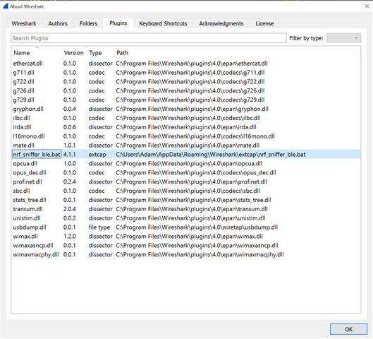

Hi all,
Yet another issue with extcap.
Windows 10, nRF52840 Dongle. Python 3.11 is installed, pyserial is installed, psutil is installed.

I note that there's no devices shown in the extcap output (even when running as Administrator). However, C:\Users\Adam\AppData\Roaming\Nordic Semiconductor\Sniffer\logs\log.txt shows something trying to use COM5 (which is the nRF COM port) seemingly without success.
26-Dec-2022 15:26:55 (+1100) INFO: Software version: 4.1.1
26-Dec-2022 15:26:55 (+1100) INFO: Started PID 27592
26-Dec-2022 15:26:55 (+1100) INFO: Namespace(capture=False, extcap_interfaces=True, extcap_interface=None, extcap_dlts=False, extcap_config=False, extcap_capture_filter=None, fifo=None, extcap_control_in=None, extcap_control_out=None, extcap_version=None, device='', baudrate=None, only_advertising=False, only_legacy_advertising=False, scan_follow_rsp=False, scan_follow_aux=False, coded=False)
26-Dec-2022 15:26:55 (+1100) INFO: Opening serial port COM5
26-Dec-2022 15:26:55 (+1100) INFO: closing UART
26-Dec-2022 15:26:56 (+1100) INFO: closing UART
26-Dec-2022 15:26:56 (+1100) INFO: Exiting PID 27592
Nothing is shown in the Wireshark debug console, and no devices are shown in the GUI.
