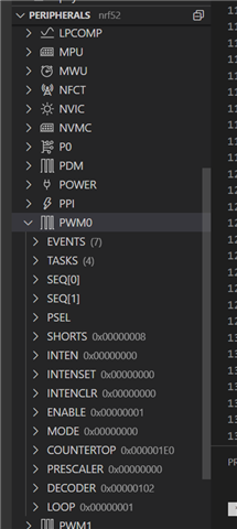

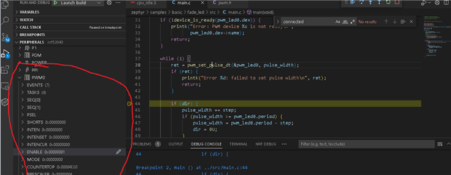

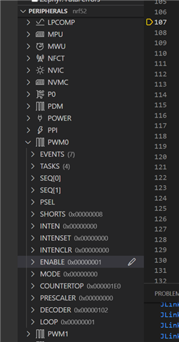

PWM not working after upgrade to nrf Connect SDK 1.9.1
Since upgrading to nrf Connect SDK 1.9.1, I no longer have PWM output. No errors returned when calling pwm_pin_set_usec, yet no output.
I tried upgrading to the latest nrf Connect SDK (2.2.0), thinking that perhaps a bug was fixed, but the number of changes (include paths, etc) was too daunting.

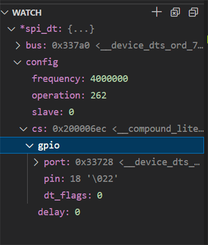

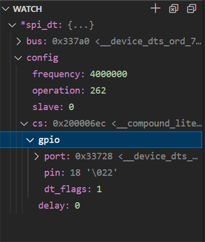

  • Some additional data. I think that my configuration of the DTS is correct. If I breakpoint in my SPI code at line 50 above, I can watch the spi_dt variable. If I set the cs-gpios to GPIO_ACTIVE_HIGH, I get the following:
    If I set the cs_gpios to GPIO_ACTIVE_LOW, I get the following:
    So, I think that I am properly setting up the device tree, it just seems that the code that is supposed to interpret the dt_flags field is not honoring it when configuring the chip select. This is quite frustrating since I am so close to getting my device to work, but this one thing makes it completely useless.

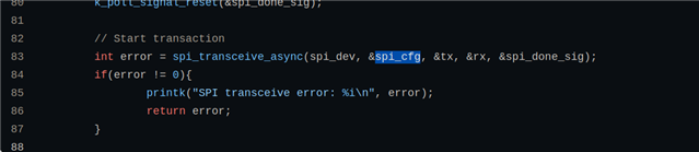

    A colleague of mine has an NCS-SPI-Master-Slave-Example.

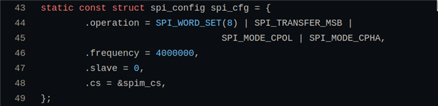

    In this sample,  it looks like he has to get the GPIO configuration manually from the devicetree to use for his SPI functions:
    It looks like you are creating spi_cfg manually in your code posted below.
    But you set the CS pin to ACTIVE_LOW in your code manually as well, so I would think this should be enough hmm.
