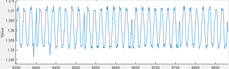

My project is displaying ADC datas, Real-time based.
ADC : ADS7054.
SDK : 17.1.0 nRF5 SDK
softdevice : s140
chip : nrf52840
Master Boards SPI Timing : (below images) **
I use SPI packet size 8bit.
2*packet define 1ADC data(14bit).
1 Sample is 2packet.
ADC data read from other boards, which is spi Master board.
spi Master board send datas, Format is SPI_MODE 0.
SPI_MODE Setting : //infocenter.nordicsemi.com/index.jsp?topic=%2Fcom.nordic.infocenter.nrf52832.ps.v1.1%2Fspi.html
I just merged 2 example projects,  ble_app_uart and spis.
and testing in 1-kHz signal, graph is very rough..
*Every 120 Samples, loss some datas.
After BLE communication,  data plot is below. (using MATLAB)
In debug terminal SPI buffer data plot is below.
plots are same...
i think this means
something caused in SPI communication..
this is my Spi & ble sending code. SPI instance is 1.
I want Sampling 10-kHz sinusoidal signals and plotting in real-time, SPI + BLE copmmunication.
Thank you.

    The max. throughput you can get with the Softdevice is shown in the specification here: Bluetooth Low Energy data throughput. Although this is likely to be limited by your central (PC).
    Does the data packet length get increased in your gatt_evt_handler() callback after the connection is established? In any case, the throughput will become better if you can fill the full packet length (m_ble_nus_max_data_len) with multiple ADC samples instead of sending only one sample in each notification packet.
    You may also want to increase the hvn_tx_queue_size via the sd_ble_cfg_set() API in ble_stack_init(). This will allow you to queue up more notification packets before ble_nus_data_send() starts returning NRF_ERROR_NO_MEM.
