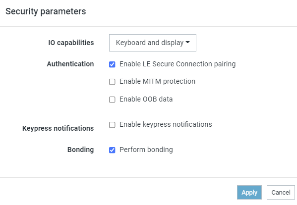

2. Set the desktop BLE tools security parameters as shown below.  I am using nRF Connect for Desktop Bluetooth Low Energy Standalone v4.0.0, but I think the problem has existed with many older versions too.
3. Initiate the BLE connect from the BLE tool.
4. In the BLE tool, enter the passcode printed in the peripheral's terminal window.

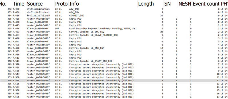

9. Wireshark shows the following for this reconnect attempt:
You can see in the Wireshark log that the central (BLE tool) repeatedly sends a packet of length 5 bytes but without any response from the peripheral.
In the sample app, I also enabled printing the sniffer key by setting  CONFIG_BT_LOG_SNIFFER_INFO=y.  However, even Wireshark is not able to decrypt the encrypted data when I provided it with the SC LTK.
I don't know if this is an issue with the BLE tool or the NCS/Zephyr.  Regardless, it seems like a basic use case that should work out of the box.
Could it be that the BLE tool is not encrypting correctly?

  • Hi  ,
    I don't think your issue is the same, because the root cause of variant's issue is in the nRF Connect for Desktop BLE feature.
    By the way, when you reply to old threads, there is a chance that it has already been closed, and Nordic's Application Engineers like me won't get notified of your reply. It happened this time, and I only found your reply while looking up my old cases.
    If you run into such situation, please consider opening a new question instead.
