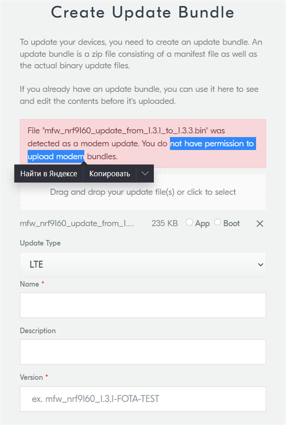

1) First, We cannot add any modem firmware to the bundle.
We received the message that we don't have permission to upload the modem.

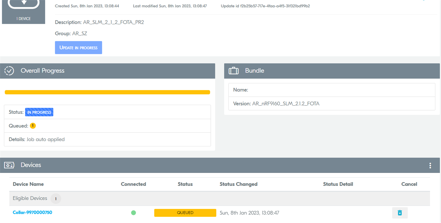

2) Second: If we try to follow your instruction (from "FOTA_AT_commands.rst").
Having previously created the group, bundle, and update, we further waiting that something to happen (status of update: is progress), but nothing happened:
We suggest that the next step should be executed the next  AT#XFOTA=1,"<URL of .bin update file>" command.
But where and how we can get the URL address from the created update?

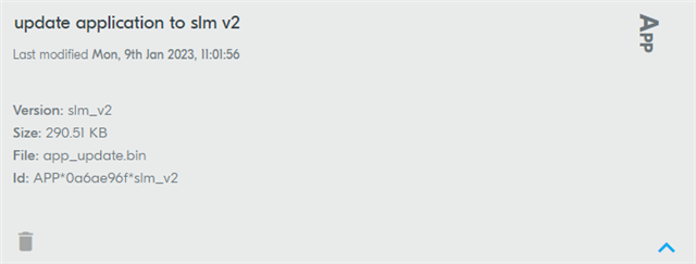

  • Hi Stas,
    1) Only Nordic official MFW can be programmed into the nRF9160 modem, we have provided all the available MFW bundles on this page. You can create application FOTA bundle from this page. For example:
    2) Please test the nRF Cloud FOTA function with nRF9160: Asset Tracker v2 — nRF Connect SDK 2.2.0 documentation (nordicsemi.com), SLM does not have the implementation to support managing FOTA tasks from the nRF Cloud side.
    FOTA AT commands — nRF Connect SDK 2.2.0 documentation (nordicsemi.com) is not specifically related to nRF Cloud. You can trigger the device to download firmware generally from any remote HTTP/HTTPS file server and upgrade itself. The following samples explain how to use AWS to build this kind of file server and you can upload a firmware file and get the link from there.
