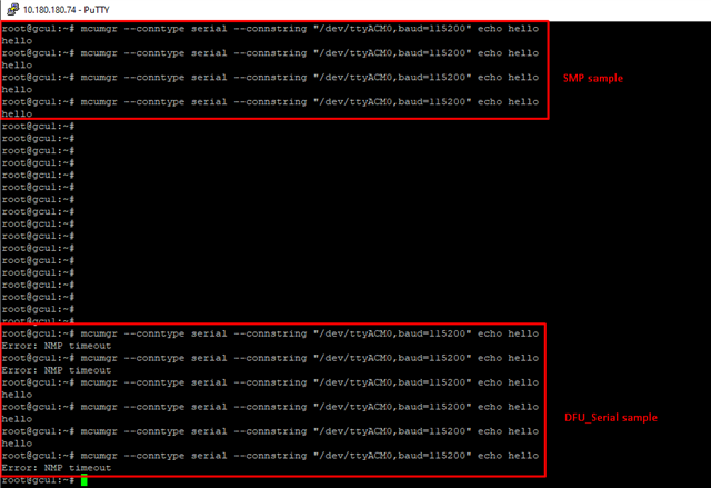

  • Nice! Now it can be signed correctly and zephyr.signed.bin has been generated and flashed!
    But now appears a new problem, I cant echo nothing:
    root@gcu1:~# mcumgr --conntype serial --connstring "/dev/ttyACM0,baud=115200" echo hello
    Error: NMP timeout
    root@gcu1:~# mcumgr --conntype serial --connstring "/dev/ttyACM1,baud=115200" echo hello
    Error: NMP timeout
    ACM0 and ACM1 are the ports that appears when I connect the nrf52840DK. I have disables Mass Storage Device.

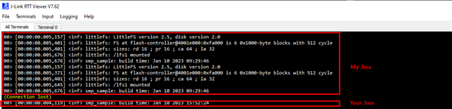

  • The result is exactly the same. When I flash your .hex file, i reconnect the USB to my windows laptop and I can connect RTT Viewer to see this:
    But If I connect the board to my RaspberryPI, I cant see nothing:
    Error: NMP timeout
    Error: NMP timeout
    root@gcu1:~# nrfjprog --com
    1050291266    /dev/ttyACM1    VCOM1
    1050291266    /dev/ttyACM0    VCOM0
    The MSD is disabled.
    Even I can connect via RTT through my Raspberry:
    Linux gcu1 5.15.56-v8+ #1575 SMP PREEMPT Fri Jul 22 20:31:26 BST 2022 aarch64
    The programs included with the Debian GNU/Linux system are free software;
    the exact distribution terms for each program are described in the
    individual files in /usr/share/doc/*/copyright.
    Debian GNU/Linux comes with ABSOLUTELY NO WARRANTY, to the extent
    permitted by applicable law.
    Last login: Tue Jan 10 15:41:39 2023 from 10.180.180.121
    root@gcu1:~# JLinkRTTClient
    ###RTT Client: ************************************************************
    ###RTT Client: *               SEGGER Microcontroller GmbH                *
    ###RTT Client: *   Solutions for real time microcontroller applications   *
    ###RTT Client: *                                                          *
    ###RTT Client: *       (c) 2012 - 2016  SEGGER Microcontroller GmbH       *
    ###RTT Client: *                                                          *
    ###RTT Client: *     www.segger.com     Support: [email protected]       *
    ###RTT Client: *                                                          *
    ###RTT Client: *                                                          *
    ###RTT Client: * SEGGER J-Link RTT Client   Compiled Dec 22 2022 16:23:51 *
    ###RTT Client: *                                                          *
    ###RTT Client: -----------------------------------------------
    ###RTT Client: Connecting to J-Link RTT Server via localhost:19021 ...
    ###RTT Client: Connected.
    SEGGER J-Link V7.84a - Real time terminal output
    J-Link OB-nRF5340-NordicSemi compiled Nov  7 2022 16:22:01 V1.0, SN=1050291266
    Process: JLinkExe
  • It works! I have to build it with the next .conf:
    west build -b nrf52840dk_nrf52840 zephyr/samples/subsys/mgmt/mcumgr/smp_svr -- -DOVERLAY_CONFIG='overlay-shell.conf'
    And now it prompts something:
    hello

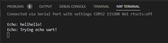

  • Have you tried to test with any UART example ? Please use the uart sample in the SDK.
    Regarding your last question, could you please try confirm instead of test ?
    Could you check the RTT log when you do confirm / test ?
    I would suggest to try putting some LED blink in the application so that you know when the new firmware is running you can detect it with the LED (you can change the blink rate for example, or change the LED pin on the new image that you update)
  • I have tried the sample echo_bot and it's working perfectly, connected via Visual Studio Code in windows.
    I have noticed that there is problems when I echo something with the Serial_DFU_hello_world but SMP server sample works like a charm:

    So I tried to connect to my board with RTT in my windows and I get the correct message printed WHILE I see the led is blinking correctly.
    My next step was connecting the board to my RaspberryPi, where I tried to echo something with no results:
    Error: NMP timeout
    Error: NMP timeout
    Error: NMP timeout
    root@gcu1:~#
    But I can see the led is blinking. RTT is not printing nothing...

    The problem of lack of communication persists, When I type "mcumgr [..args..]" usually I receive  "Error: NMP timeout", but if I push "ctrl+c" and type again, it usually works.
  • Hi Juan,
    Could you clarify if you can use dfu with serial or you need to use dfu with shell to be able to make it work  ?
    I think it's worth it to verify that UART is working normally. So you should try to test only uart, no DFU to be sure that the connection is OK.
    There isn't a simple UART example in the SDK but you can try to test using the BLE UART example. Please look at the peripheral_uart example.
    Other example also uses UART for logging that you may want to test.
