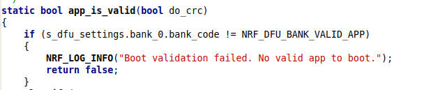

    Deep diving why the app was executed, we found out that the line
    if (!app_is_valid(crc_on_valid_app_required())) inside dfu_enter_check()
    was commented out, to speed up the startup and save energy (our application runs with a very low duty cycle and every millisecond counts to reach year-long battery life)... So basically the app CRC is never verified by the DFU. This allows the unexpected execution of the old app just after the DFU/SD update.
    The good news: bringing back the CRC control, the OTA update is now successfully completed Slight smileThank you for your support all along the way!
    Just as a closing note: do you see any viable alternative to bringing back the full CRC calculation in the DFU? We would really like to keep the boot-up as fast as possible.
    I am glad to hear that you found the issue Slight smile The problem with commenting out the line you mentioned is that you not only skip the CRC checksum validation, but also the .bank_code check here:
    This explains why the bootloader attempted to boot the application before it had been uploaded.
    To correctly disable CRC validation, you can use the '--app-boot-validation NO_VALIDATION' option when you generate your Bootloader settings page and DFU package with nrfutil.
