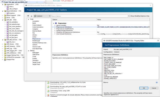

1: What is the standard way to include the defintions discussed in IN-141 ("ENABLE_APPROTECT") ? - Do i manually make these definitions? or are they already in a file, waiting to be enabled? similar to the SDK_config.h file?

    1&2: The standard way of defining ENABLE_APPROTECT is define it in the Preprocessor Definitions. It's mentioned in Daniel's blog "In the nRF5 SDK the ENABLE_APPROTECT symbol can be added to a project's preprocessor defines". If you use SES it should look like this:

    If you define ENABLE_APPROTECT in the preprocessor definitions, the code will not write to NRF_APPROTECT->DISABLE, meaning that the chip will be protected and the debugger port will be blocked. In addition to not write to NRF_APPROTECT->DISABLE, it will write to NRF_APPROTECT->FORCEPROTECT as an extra layer of security as mentioned in the specification.
    If you don't define ENABLE_APPROTECT in your preprocessor definitions, the code will write to NRF_APPROTECT->DISABLE. The value it writes to NRF_APPROTECT->DISABLE is the value in NRF_UICR->APPROTECT. This is to make the behavior align with what we have in older versions of the chip. And, in my opinion, it was what Daniel wanted to tell when he mentioned "Then a function in MDK version 8.45.0 (or newer) is executed during startup to complete the firmware step. If the firmware step is skipped then the device may appear locked but it will not be completely protected."
    If you don't define ENABLE_APPROTECT, and then you only write to NRF_UICR->APPROTECT to enable APPROTECT, you are basically removing the software protection of the APPROTECT, and only rely only on the UICR.APPROTECT. This makes the chip not much more protected compare to version 2 and earlier.

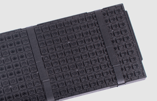

    6. If you look at the Order code here, you can find that the T code you see is the Container Code. T stands for Tray, the other options are R or R7 which are  the Reel. It's just the packaging of the delivery of the chips. Here is Tray:
