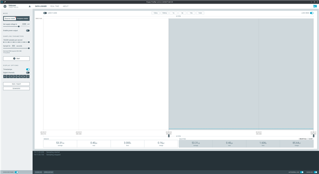

I just got a PPK2 and started testing some devices (ESP8266). I quickly noticed that the time in the graphs was completely off.
Have a look at this screenshot:
Without even activating the power supply, just starting measuring and stopping 5 seconds later. You can see down in the log:
19:17:20.698	Sampling started
19:17:25.735	Sampling stopped
But if I click on SELECT ALL it says 1.606 seconds
So basically it reports around 1 second for every 3 actual seconds.
It doesn't matter how many samples per second I take, it does it all the time.
Zooming doesn't change anything, it is still wrong.
Tried with 3 different USB ports already both USB2 and USB3, different cables too.
And the DUT I don't think it matters, tried a few already but same problem regardless.
Should I return the unit? Or is it a software error? Any workaround?

Edit: tried on windows, same problem.
Edit2: tried on an ancient Intel laptop, with windows, and it works fine. So it is not the hardware, it is the software that is broken. And has been broken for 2 years according to the reports: github.com/.../141

  • I connected it to a USB3 hub and it works fine on my AMD machine.
    I have been experimenting with the python PPK2 API and discovered that just reading a fixed amount of bytes from the serial port takes longer when connected directly compared to the USB hub.
    When connected to the hub:
    Bus 003 Device 023: ID 1915:c00a Nordic Semiconductor ASA PPK2
    reading 8192 bytes took 21.00ms
    reading 8192 bytes took 20.00ms
    reading 8192 bytes took 22.00ms
    When connected directly to one USB port:
    Bus 001 Device 031: ID 1915:c00a Nordic Semiconductor ASA PPK2
    reading 8192 bytes took 64.00ms
    If a sample is 4 bytes this means that:
    • the hub is able to read 2048 samples every 20ish milliseconds. That is a rate of  ~100k samples per second. As expected.
    • when directly connected it reads 2048 samples per 64ms. That is a rate of 32k samples per second. That is only 32% of the theoretical sample rate.
    And if the timing on the graph relies on the 100k theoretical rate, when that rate is in reality only 32% then yeah, 5 seconds would look like only 32% of it, so 1.6 seconds.
    But why does reading take so much longer when connected to a USB port directly compared to having a USB hub in between?

  • TheBronx said:
    I keep wondering one thing though: if there is some problem or limitation that makes the communication too slow, so measurements are lost, why does the problem happen at any sample rate? If I set it to 100k and I can only get 32k, well then anything below 32k should work fine right? But no.
    The sampling rate is actually always 100kHz. When selecting anything below you will still have a sample rate of 100kHz but use an average filter.
    That is most likely the reason.
