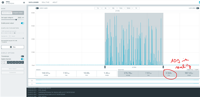

  • Hi , I have also the timing issue. When i click on 10sec for a screen , the capture full windows is like more than  two times the selected value. The selection window is also not giving the good duration too:
    My advertising period is 10sec, i can also count it. But selected time said 3.566sec , that's not correct.
