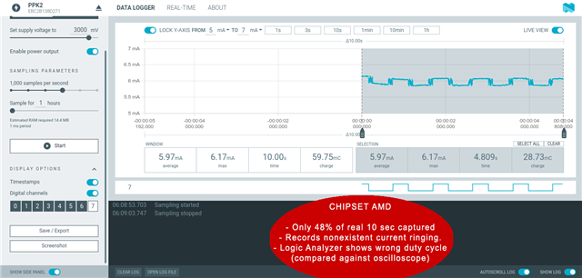

  • I have the very same issue: the recorded time is only 32% of real time. I tried multiple USB ports (2.0 / 3.1), cables, OS (Windows 10 and Linux Pop!_OS 22.04) and a USB hub. The best combination still didn't go over 34%.
    This is really messing with my calculations.
    My motherboard is an "MSI - AMD AM4 mATX B350M gaming pro" (chipset = B350M).
    I will see if there are BIOS updates available and report back.

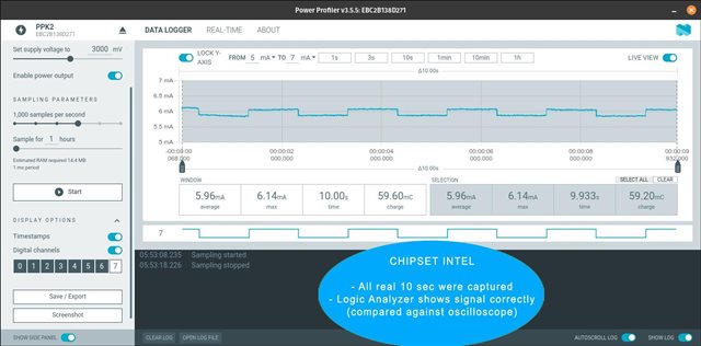

    Reporting back: I updated to the latest BIOS (2023-05-23-beta) and the problem persists.
  • But after tweaking many options on BIOS (most of which I don't understand) it improved from 32% to 48% of real time being captured. That also improved a bit the ringing that the PPK2 was displaying on both the current graph and the LA graph (the signal was fine as I probed it with an oscilloscope right at the PPK2 PCB).
    But still, the LA was drawing the wrong duty cycle, and the ammeter losing samples and hallucinating about ringing. Finally, I tried a live Linux USB drive ( Pop!_OS 22.04 ) on a borrowed INTEL laptop and connected PPK2 to it without disturbing the test circuit. All the problems disappeared.
    As the two pictures show, apparently the only thing PPK2 seems to get right on AMD systems currently is the average current. Everything else is dependent on chipset's luck.
