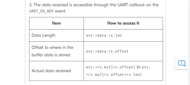

  • hello, thanks for answering me, the connection will be with another board which transmits the information given by a sensor connected to it, through uart, at the moment they are a numerical data, my idea is that the nordic receives the information and prints it on the console at the moment.
  • Have you tried running the example from Lesson 5 of the devacademy course? You could try to printing rx_buf.
    There is also another sample demonstrating asynchronous UART. Please note that sample was tested using nRF Connect SDK v1.9.1. I suggest testing it using v1.9.1 before migrating it to v2.x.x.
  • hello greetings, I have been using that example as a base, but from what I understand is that this example is to be used with the console, and I do not fully understand how it would be for my case, since I currently have the following:

    2) I am using the course example as a base, but I don't understand how to get the data, nor how to manipulate it. I know that in the callback function it tells me that I can access it but I don't understand how it does it and I would really like to have more clarity on that aspect.

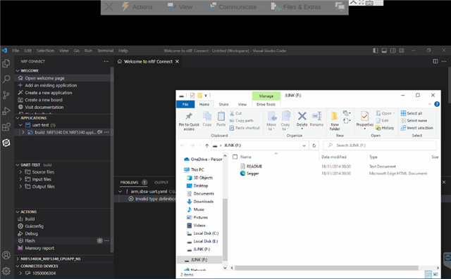

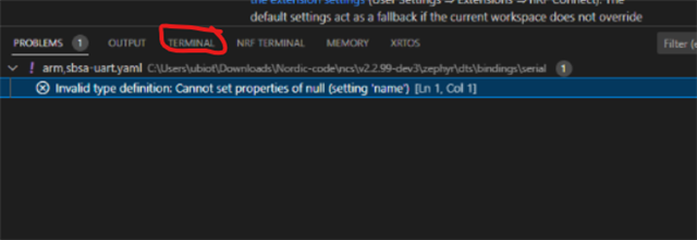

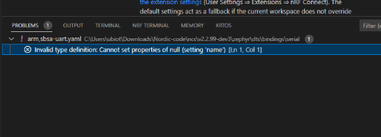

  • hello thanks for answering this problem too i tried to run the uart example from dev academy course but every time i build it gives me the following error:
    I tried to change the version, taking into account that in version 2.2.0 every time I build the application, some files are not generated in the zephir folder inside the build, but the error still persists, not only that but also when I try to pass it al nordic opens the folder where the segger part is, what do you suggest I do?
  • Hi brando,
    Sorry for the delay.
    Could you please check the build log from the 'terminal' tab in nRF Connect for VS Code?

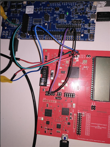

  • Hello I have the next scenario:
    I work with two boards:
    Texas PCB: EVM430-FR6047 MCU018 PCB Rev A
    Nordic Semiconductor PCB: nRF5340 DK
    The texas board is connected with a ultrasonic sensor and sends the flow volume data through uart protocol. So the idea if forwarding the data coming from the MSP430 (ultrasonic flow sensor) to the nRF5340 DK for further processing via uart.
    So I am wiring both PCBs this way:
     J3: TXD (black cable) --> nRF5340 DK P1.15
    J3: RXD (purple cable) --> nRF5340 DK P1.14
    I'm trying to use the dev academy example as a guide but it doesn't even work for me, it builds fine but every time I pass them to nordic it only opens the segger folder.
    The window should normally not pop up. What exactly do you click on when this occurs? Does this only happen with this specific application? Are you able to build and flash other samples, like the hello_world sample?
