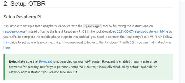

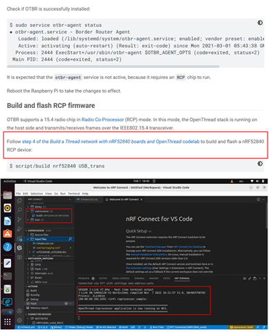

    I refer to your webinar "Developing Matter Products with nRF Connect SDK" dated October18, 2021. https://webinars.nordicsemi.com/developing-matter-products-with-nrf-4
    I also refer to video duration from 19:12 to 20:52.
    Kindly refer to the error in the attached text.

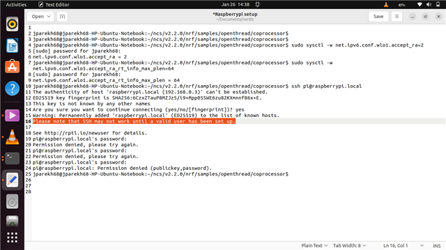

    "Please note that SSH may not work until a valid user has been set up."
    I am using Ubuntu Desktop. I created the MicroSD Raspberry card here on this Ubuntu machine. I did not get any prompt to generate a password.
    As a consequence I am not able to SSH Raspberrypi.
    Kindly help.
    Thanks for the reply.
    Guides are good but are not much of a help many a times.
    The problem I referred to was solved by pressing CTRL +SHIFT + X key while on the rpi-imager window and then setting a password for the raspberrypi. and then run the "WRITE" on imager.
    Thanks once again.

    2. RCP Firmware successfully flashed on nRF52840 DK Board. See below:
    3. We are not able to figure out next steps from the Documentation as to way forward. Our objective is to form a Thread Network and run example "Lock" using Android Chiptool.
    4. Our RCP Board is now connected to Raspberrypi.
    Thanks.
    Jogen
    jparekh68 said:
    1. OTBR is successfully installed.
    Great!
    The original question in this case has been answered. If you have further questions about Matter or Thread,  please create a new case.
