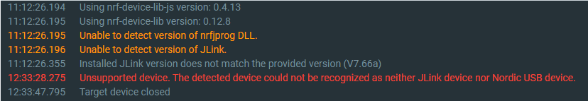

Hello, after installing nRF Connect and nRF Programmer v3.0.4, I cannot connect to my nRF5340-DK.
The DK is corrctly recognized as a mass storage device, and it is listed as "J-Link" (with a number below) under "SELECT DEVICE" in nRF Programmer, but if I select it, the log says "Unsupported device":
I have SEGGER JLink v7.84b (64 bit version) installed, which is newer than the driver version that came with the latest nRF Connect for Desktop.

    11:12:26:355 Installed JLink version does not match the provided version (V7.66a)
    Could you try again using version 7.66a and see if that solves the issue? Or you can install by the latest version of nRF-Command-Line-Tools.

    I uninstalled JLink v7.84b (64 bit) and installed JLink v7.66a (64 bit). Same problem as before.
    Then, I additioanlly installed JLink v7.66a (32 bit) Now JLink was recognized and Programmer is working.
    There seems to be a problem when it comes to 32 bit and 64 bit driver versions. I never experienced any problem with 64 bit JLink driver on any other software, so I think it should also work with nRF Programmer... well, maybe you can fix it in a coming release, or otherwise update your tutorials on infocenter.nordicsemi.com / developer.nordicsemi.com so that it is clear that the 32 bit driver is needed.
    Update: I uninstalled both v7.66a driver versions again and installed v7.84b (first 64 bit, then 32 bit). nRF Programmer still recognizes my nRF5340-DK correctly now.
    Info: I did not check if thre is a different effect if I install the 32 bit version before 64 bit.
    Info: v7.84b 64bit + 32bit also works for "Bluetooth Low Energy" tool and RSSI viewer in combination with nRF52832-DK. I didn't have time to check if the error occurs there, too, if only the 64 bit driver version is installed.
    Conclusion: The problem is related to 64 bit driver versions, not newer JLink driver versions.
