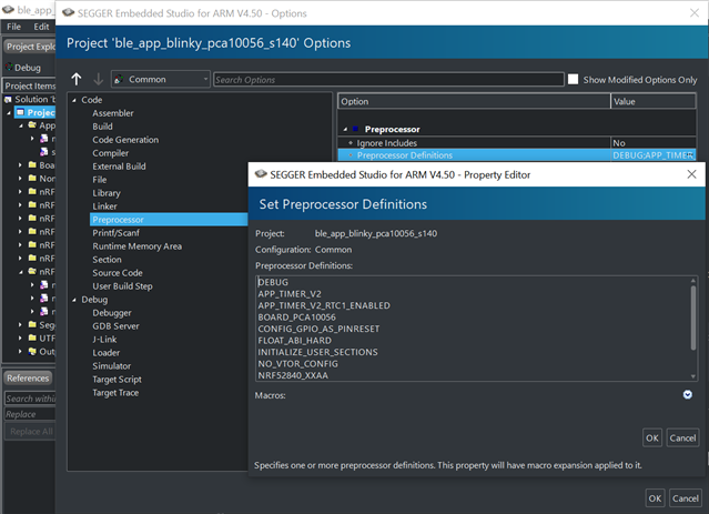

    Do you have logging enabled? If so, is there an error code printed by the logger when this happens?
    Please make sure to have DEBUG defined in your preprocessor defines like so:
    This will make your logger output a detailed error message whenever a non-NRF_SUCCESS error code is passed to an APP_ERROR_CHECK. Please let me know what this error message reads, and which line of code it is pointing to.

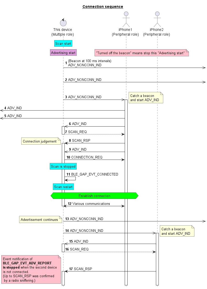

  • Hello Karl,
    The translation doesn't seem to convey my intentions very well.
    Can you make sense of the situation in the diagram below?
    Best regard.
    No worries - I try to understand as best I can, and then ask if anything is unclear.
    Thank you for providing the diagram, and for your extreme patience with this.
    Looking at the diagram it seems to me that your iPhone1 and iPhone2 also needs to have the central role for the scanning they do before starting to advertise.
    If I could ask, why are they not always just advertising? Why do they need to pick up on the 'This device' advertising before they start their own advertising?
    This is very expensive with respect to power consumption, since the scanning devices will need to be scanning 'constantly', which has a much higher current consumption than advertising.
    An additional question is also; are you in control of the application running on the iPhone side of the link?

  • Hello Karl,
    > Why are they not always just advertising? Why do they need to pick up on the 'This device' advertising before they start their own advertising?
    This will be a requested specification from the customer.
    Since the information is put in SCAN_RSP, it is considered for security reasons that we do not want it to be advertised unless it is necessary.
    > Since the scanning devices will need to be scanning 'constantly', which has a much higher current consumption than advertising.
    Since a iPhone always accepts iBeacons, I'm thinking of using it.
    > Are you in control of the application running on the iPhone side of the link?
    Yes, we also create control apps for the iPhone.
    > Is this all related to the 'this device' in the diagram?
    Yes, It will be the operation when "Advertising Start" in the figure is stopped.
    > Is the 'this device' battery powered, or is this a mains powered device?
    Of course, it is a mains power supply, and it will always operate without sleep.
    Best regard.
    Aha, I see. I just wanted to point out that this is not the most power optimized approach, but if that's already considered and decided on then you can disregard the recommendation :)
    If I could ask, what kind of information is it that will be available in the scan response?
    This information will be available to any device that sends a scan request in the time that the device is advertising, just so you know.
    Thank you for clarifying this.
    In general, scanning will utilize the radio 100% of the scanning window, so if you need other tasks interleaved with this (like advertising) you need the scanning window to be smaller than the scanning interval, so that there is time inbetween the scanning to perform the other radio activity.
    Karl
