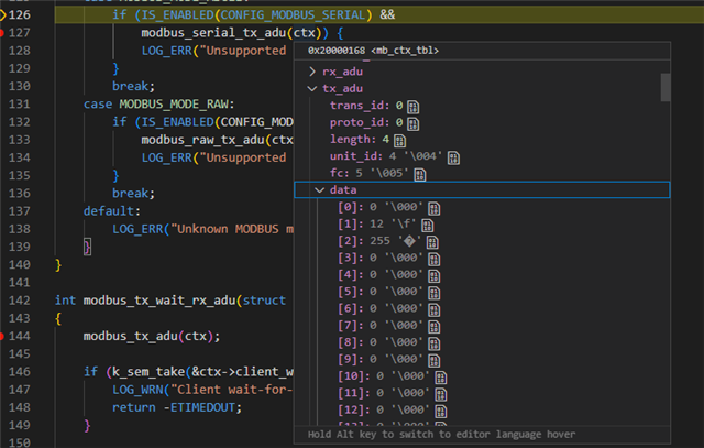

Hi everyone
I am testing the modbus library over zephyr framework (Nrfconnect (skd v2.2.0 ) on visual studio code).
I started from the examples (link) and I am implementing a modbus master.

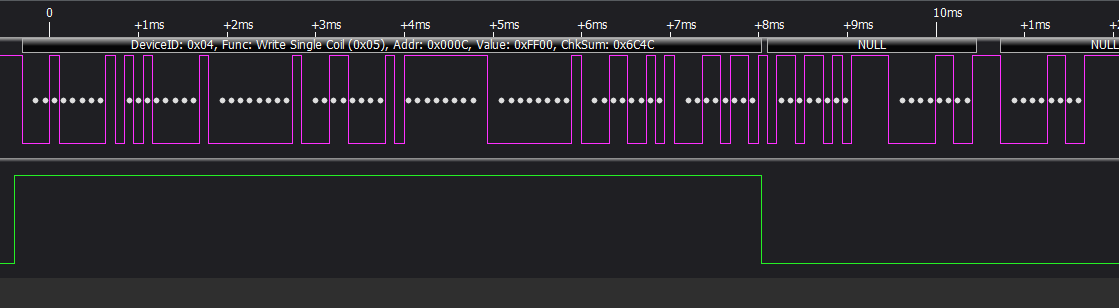

In the image below you can see, by status analyzer, the TX and DE pin before conversion to RS-485.
The problem I am experiencing is that more bits are being transmitted than are needed.
my code is quite simple:

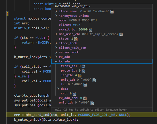

    modbus_write_coil(client_iface, 4, 12, true);
So I am trying to set coil 12 of slave 4 to true.

so needed symbol that have to be send di uart are: 40-5000-12-FF00-6C4C.

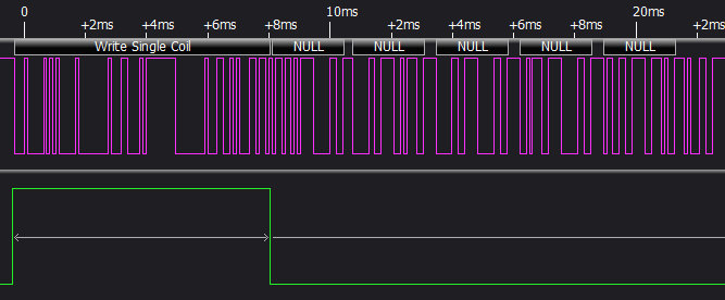

Via logic analyzer i verified that the trasmission is correct except that some bit are sent (number and shape change every time).
As you can see till DE is enabled (tx enable sent to rs 485 converter) is ok: all simbol are correct. the problem come after transmission.
I've been trying to dig into what's going on.

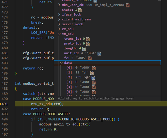

In a nutshell, I have verified that the modbus stack works perfectly, i.e., from the set coil command I get the correct modbus sequence and the same data is copied with a memcopy into the buffer of the uarte. the problem is that the uarte transmits other symbols that I do not understand by whom they are being queued.
With more detail:

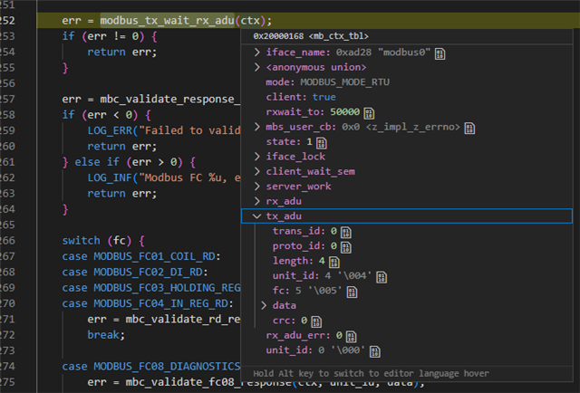

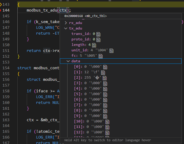

-->(modbus_client.c) mbc_send_cmd(ctx, unit_id, MODBUS_FC05_COIL_WR, NULL);  work fine
--> modbus_tx_wait_rx_adu  work fine
--> modbus_tx_adu(ctx); work fine
-->   modbus_serial_tx_adu(ctx))
-->        rtu_tx_adu(ctx);

then from code:
tx byte = 8 so ok
crc 16 is correct
cfg->uart_buf[0] = ctx->tx_adu.unit_id;
    cfg->uart_buf[1] = ctx->tx_adu.fc;
    tx_bytes = 2 + ctx->tx_adu.length;
    data_ptr = &cfg->uart_buf[2];
    memcpy(data_ptr, ctx->tx_adu.data, ctx->tx_adu.length);
    ctx->tx_adu.crc = crc16_ansi(&cfg->uart_buf[0], ctx->tx_adu.length + 2);
    sys_put_le16(ctx->tx_adu.crc, &cfg->uart_buf[ctx->tx_adu.length + 2]);
    tx_bytes += 2;
    cfg->uart_buf_ctr = tx_bytes;
    cfg->uart_buf_ptr = &cfg->uart_buf[0];
    LOG_HEXDUMP_DBG(cfg->uart_buf, cfg->uart_buf_ctr, "uart_buf");
    LOG_DBG("Start frame transmission");
    modbus_serial_rx_off(ctx);
    modbus_serial_tx_on(ctx);

in conclusion following the lines of code the modbus stack boxes the symbols correctly and passes them to the serial communication part.
Maybe it's just a matter of setting something up correctly.
Can you help me with this?
In my opinion it is something at the uarte level
  • in conclusion following the lines of code the modbus stack boxes the symbols correctly and passes them to the serial communication part
    If I read this correctly, what you are trying to write here is that the modbus requests to write some data which is going down to the backend uarte drivers. The transmit request from the uarte API also looks same with the right data and size, but when the uarte is transmitting the data on the pins, then the transmitted packets looks different than the one requested to send in the API?
    This seems strange and I have not seen this before. If you are very confident that the uarte drivers are being requested to send the right data but data on pins is wrong, then it most likely sounds like the issue with the pull configuration of the pins. I thought that each uarte pin pull configuration is set at the time of uart init, not sure how it goes with modbus libraries. PLease check if the uarte pins have the right pull configurations.
