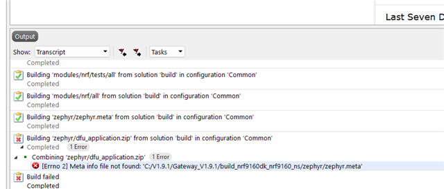

  • I thought about creating a new ticket but wanted to leave the history here. I'm now trying to start using the latest version of the SDK V2.5.1 which obviously uses VS Code.
    However the problem still exists that when I load the new SDK, I can no longer use Segger, which makes things very problematic.
    The error is unable to parse json string.
    Things have changed, I noticed the post where a shortcut was created to load Segger directly from the bin directory.
    This did allow Segger to open the project, however it wouldn't compile, giving the following error:
    I had to once again remove the latest SDK V2.5.1 then it compiled as expected.
    This makes it very difficult to try and upgrade our software using the new SDK, when we are unable to abandon Segger at the moment.
    Help would be very much appreciated please.
  • Hi John,
    Do you get the problem when trying to open the older versions separately (i.e. not via the Toolchain Manager)?
    Priyanka
