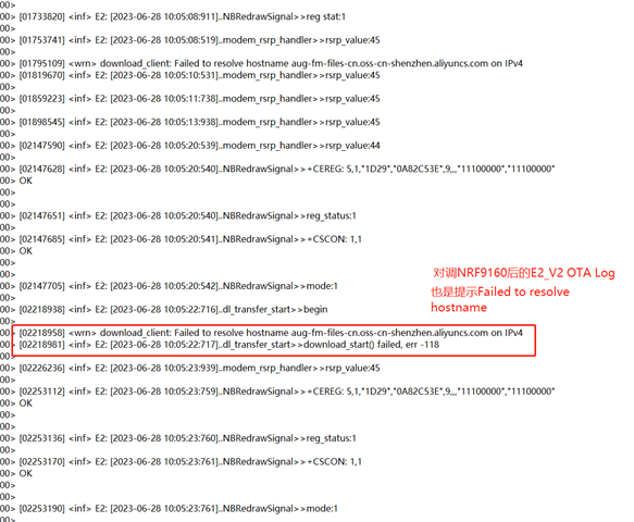

Why did the 9160 fail to resolve the domain name?
I developed a product on 9160 using the ncs1.9.0 SDK and the 1.3.2 modem firmware. When debugging, I found a problem. That is, when connecting to a domain name, the modem returned the error of domain name resolution failure. However, using the same hardware device, running the ncs1.2.0 SDK can connect to this address, that is, there is no problem with the network and the background domain name, Then why is there an error on ncs1.9.0? This is the modem trace I captured.

  • Hi Charlie:
    After a long period of comparative testing, we eliminated SIM card issues, operator issues, and server issues one by one. Based on the results of the comparative testing, we can draw the following conclusion:
    1. Whether the old hardware circuit board is equipped with firmware of ncs1.2.0+modem fw 1.2.0 or ncs1.9.0+modem fw 1.3.2, it can interpret and connect my domain name normally;
    2. The new hardware circuit board equipped with firmware of ncs1.2.0+modem fw1.3.2 can work normally, but firmware equipped with ncs1.9.0+modem fw1.3.2 will return a domain name explanation failure.
    Therefore, we suspect that either there is a significant difference in domain name resolution between ncs1.9.0 and ncs1.2.0, or there is an issue with the layout of our hardware circuit board. What should we do next?

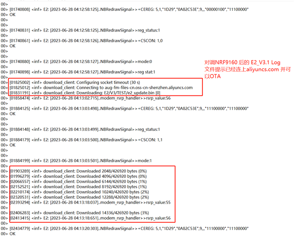

  • Hi Caerlie,
        1)  I will share the old hardware and new hardware
        2)Regarding the issue of log and modem trace output, from the application layer's log, it runs to file download_ The function host for client. c_ In lookup, an error was returned when executing getaddrinfo, and unfortunately, regarding the trace information of the modem, as I mentioned before, when parsing failed, an error was immediately returned and no useful information was found in the trace.

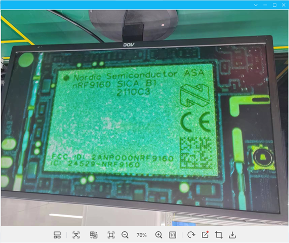

    5. We just conducted another experiment: porting the 9160 from the old device to the new device, and the new device can also operate normally. This indicates that the problem may not be caused by our principle design, but is related to the 9160 itself. Strangely, the old device and the new device use the same batch of 9160 (its silk screen is the same: nrf9160 SICA B1 2110C3), and both are versions of mfw1.3.2.
  • Hi Biao,
    Ok, this is very interesting to see. For the new devices, how many you have tested by far? Do all of them have the same issue?
    I will properly ask our QA team to check the nRF9160 chips you got for the next step.
    Charlie
  • Yes, we have tried many new devices that are unable to resolve domain names (greater than 20). But with the combination of ncs1.2.0+mfw1.3.2, the new device can operate normally.
  • My understanding is that when you unsoldered one nRF9160 chip from the old version device and then solder it to the new version device, then the modified new version device will work with ncs1.9.0+mfw1.3.2. Is this correct?
    if yes, could you do two more of this kind of transplants? If all the nRF9160 chips from the old version device will make modified new version devices work. Could you share the picture of these six nRF9160 chips?
    Charlie
  • Yes, after testing, we found that by disassembling the 9160 from the old device and installing it on the new device, it can work normally; At the same time, we removed the 9160 from the new device and installed it on the old device, but it still couldn't resolve the domain name. In other words, it wasn't the circuit design of our device that caused this domain name resolution anomaly, but the 9160 itself. This is very strange because from the screen printing perspective, the 9160 from the old device and the new device are in the same batch.
    By the way, they are all the same firmware, equipped with ncs1.9.0+mfw1.3.2.
