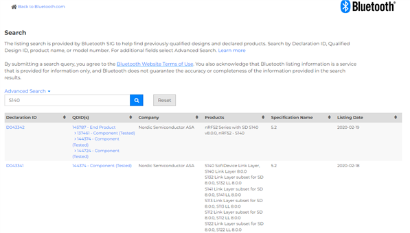

    2) we are going to passe our product by lab (LCIE bureau veritas) for EMC and radio in early march. Do I need to provide some informations on BLE stack nordic ?
    Most likely you need to provide the QDID that we provide in the bluetooth website listing for that softdevice version.
