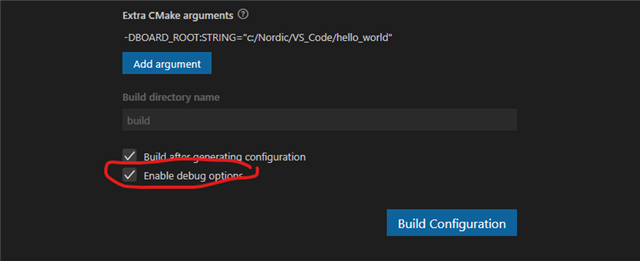

I'm looking to use a debugger with nRF Connect. So I'm starting with a build of the hello_world test for my nRF52 DK. I checked the box to "Enable debug options" and then create the build config:

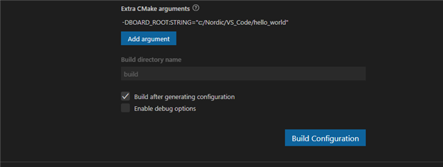

Then, I use this config to do a pristine build of the hello_world app. But when I go back to look at the build configuration, the Enable debug box is unchecked!
It unchecked itself during the build!
    This could be a bug in the VS Code extension. Enabling debug options will set the Kconfig options CONFIG_DEBUG_OPTIMIZATIONS and CONFIG_DEBUG_THREAD_INFO. So to check whether this is enabled, you can check the generated configurations. Go to hello_world/build/zephyr and open the .config file. The .config file is the file with generated configs, so search for CONFIG_DEBUG_OPTIMIZATIONS and CONFIG_DEBUG_THREAD_INFO there. If you get that they are =y, then debug options have been enabled successfully.
    You can still debug without these options enabled. CONFIG_DEBUG_OPTIMIZATIONS will optimize debugging, and CONFIG_DEBUG_THREAD_INFO enabled thread-aware debugging. However, this is unnecessary in a simple application such as hello world.
