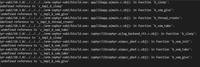

MCUBoot fails to build with Internal RC enabled without multithreading NRF52840 (NCS 2.0.0)
Hi There,
Currently running into this issue that has been discussed here, also described in this github issue here
Environment description:
- NCS v2.0.0
-  BLE Application.
- NRF52840 Using internal RC low frequency clock. (Raytac Module).
Initially my application would not boot up at all, due to not having an external low frequency XTAL, However by adding the /child_image/mcuboot.conf file with the following flag it worked like a charm:
Now that I want to use my own keys to sign the images to perform the OTA, I added this to the CMakeLists in order to use my custom keys instead of the default ones.
set(mcuboot_CONF_FILE "${CMAKE_CURRENT_SOURCE_DIR}/child_image/mcuboot.conf")
The build fails as mentioned in the tickets above.
I have got it working by enabling multithreading in the local  mcuboot.conf:
CONFIG_MULTITHREADING=y
This adds a tremendous amount of overhead to the bootloader image, from ~24 kB to 45kB.
    (mcuboot_CONF_FILE "${CMAKE_CURRENT_SOURCE_DIR}/child_image/mcuboot.conf") will overwrite MCUboots default configs. I recommend you to have a look at this sample written by a colleague of mine for how to add custom keys: https://github.com/hellesvik-nordic/samples_for_nrf_connect_sdk/tree/main/bootloader_samples/keys_and_signatures/mcuboot_smp_custom_key
    I think that if you follow this guide you will see that you don't need to add Multithreading to make it build.
    Let me know if this fixes your issues,
    Andreas
  • Hi Andreas,
    Thanks for prompt response.
    I did test your suggestion and it works, However with one caveat otherwise it would not compile in NCS 2.0.0 this Cmake command
    set(mcuboot_CONFIG_BOOT_SIGNATURE_KEY_FILE \\\"${CMAKE_CURRENT_SOURCE_DIR}/child_image/private-key.pem\\\" )
    requires double level of escaping as stated here.
    It works for now, However I do want to have custom configuration for McuBoot for my application I am currently using ->? chiLd_image/mcuboot.conf how does the precedence work in this case, what overwrites what?
