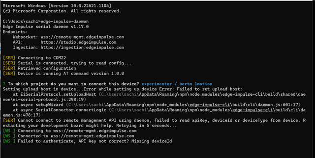

I have test with the precompiled firmware downloaded from the above link, I have flashed 2 different firmware
1. Edge Impulse: But with this firmware nor the Bluetooth is advertising nor, the daemon is recognising this board.
2. Machine Learning: This is advertising it's name but the daemon is not recognizing it as a edge impulse code
Wrapping up all suggestions, I think the machine learning sample from the nrf/application directory is useful for connecting board with edge impulse studio, as that sample is working on accelerometer and working fine on local board, but when I tried to connect it with the edge ipulse studio with the command edge-impulse-daemon , it is somewhat working but also failed with authenticate error which you can see on below screenshot.
Do you have any suggestion?
Am I using the correct sample for connecting to edge_impulse_studio?
Help me to overcome this error...

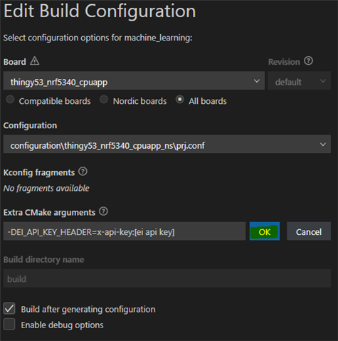

I am encountering an error while trying to download the deployment data from the Edge Impulse API for my project. The error message I receive is as follows:
error: downloading ‘https://studio.edgeimpulse.com/v1/api/175078/deployment/download?type=zip’ failed
status_code: 22
status_string: “HTTP response code said error”
I have checked my internet connection and made sure that I have the correct API key for my Edge Impulse project. I have also tried accessing the URL in my browser to see if I can download the deployment data manually and it is downloading, but I am still unable to resolve the issue.
Could you please help me resolve this issue so that I can continue with my project? I would greatly appreciate your assistance.
I am using the machine learning sample from NCS, here is the screenshot for more clarity.
I think maybe this error is due to this
But I don't know how to provide the API key, I followed the official doc https://developer.nordicsemi.com/nRF_Connect_SDK/doc/latest/nrf/ug_edge_impulse.html#downloading-model-directly-from-edge-impulse-studio
but still don't know how to add it in cmake option.
Note: I know you will suggest https://developer.nordicsemi.com/nRF_Connect_SDK/doc/latest/nrf/gs_modifying.html#cmake-options this but I still don't know how to do that.
See this example for CONFIG_EDGE_IMPULSE_URI, and The CMake option could be added by VS Code as the following figure. Don't forget to press "OK" to add the option. Here is the tutorial Machine Learning with the Thingy:53 . Hope it can help.
Amanda H.
Thanks for your help on this issue, I have resolved the API key issue, and I would like to write about the confusion which I faced.
To add the Edge Impulse API key in the CMake arguments, the following format should be used: -DEI_API_KEY_HEADER="x-api-key:[ei api key]". The "x-api-key" must be written as it is and replace "[ei api key]" with the actual API key.

But when I run the edge-impulse-daemon command on cmd, after providing credentials, when it moves to select port
I am facing the problem that it is not connecting to board instead it stays at "Connecting to COM17" for some time and then shows the "Failed to connect to COM17 retrying in 5 seconds Open (SetCommState): Unknown error code 121" this error
please help
sachinrawat said:So now the build is successful and now the library is downloaded and added to the code
Good.
sachinrawat said:I am facing the problem that it is not connecting to board instead it stays at "Connecting to COM17" for some time and then shows the "Failed to connect to COM17 retrying in 5 seconds Open (SetCommState): Unknown error code 121" this error
Are you using the correct port? In the previous figures, you used COM22.
Since the edge-impulse-daemon is not developed by us (Nordic Semi), you have to contact https://edgeimpulse.com/ for the error code. Here is their forum.
