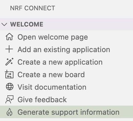

  • I will upgrade my os and test.  Here is the support information pre Ventura upgrade. thanks for your help.  Wally
    IMPORTANT: The data below could contain sensitive or confidential information about your environment.
    If you do not wish this to be seen by others, please make sure to remove it before sharing.
    For help and support, visit the Nordic DevZone at devzone.nordicsemi.com/.

  • I've upgraded to Ventura 13.2 and I still get a crash when trying to close the terminal in vs code after an nrf connect session.  Below is the nrf support generated information.  Interestingly, I don't see a new crash log in OS X console app.   At least, the date shown is from last Friday when I launched vs code after upgrading to 13.2 os x,  I did not try to close the terminal window until this morning, the 6th.  Maybe the information is valid, I'll copy it below.
    Wally
