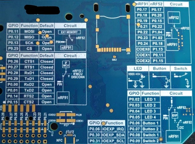

    Are you working with a custom board or the nRF9160 DK? I am asking because I wonder if the pins selected for the HX711 are available or if they are used for other board functions. P0.02 is for instance assigned to LED2 on the DK.

    1. Please I am working with an nRF9160 DK, and truly pin 2 is assigned by default to an LED. I was wondering if I should change pin 2 in the code, to an unused pin of the nRF9160DK board (pin 25) for example.

    Please try P0.10 and P0.13 for DOUT and CLK, these should be routed directly to be pin headers.

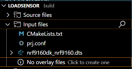

    8. The next thing will be to define the HX711 and the pins it uses, in your overlay file. To do that, start by creating an overlay file, by clicking on "create" an overlay, which you most probably don't have by now.
      Create by clicking on the "No overlay files Click to create one" option
      Open the "overlay" file and add the following code as shown below;

      		dout-gpios = <&gpio0 2 (GPIO_ACTIVE_HIGH | GPIO_PULL_UP) >;
      		sck-gpios = <&gpio0 3 GPIO_ACTIVE_HIGH>;
      		// rate-gpios = <&gpio0 4 GPIO_ACTIVE_HIGH>;
      So, if you have already checked the instructions on nobody guy's repo, you may see that my overlay code is slightly different.
      I changed the pins of "dout-gpios" and "sck-gpios" to 2 (P0.02) and 3 (P0.03) respectively, because those pins also coincide with the nRF9160 onboard LEDs 1 and 2 respectively. This is so that if the code and hardware work properly, you should see the LEDs corresponding to these pins flash their lights.
      I also commented the line for the "rate-gpios" pin, out, because as  , earlier said above, my HX711 doesn't provide room for that pin and it is not necessary in my case.
      If your HX711 does support that pin, you will have to connect the "rate-pin" of your HX711 to pin 25 (P0.25) of your nRF9160 DK, as that is the dedicated pin for clock connections on the nRF9160 DK. If you are not using the nRF9160 DK like me, then you will have to check for your dedicated clock pin by looking at the back of your board, or by checking your board specifications on nordic's website.

      When your build is done, one important thing you MUST do else your project will not work, is to enable your microcontroller board to read VDD (3V) signal. By default, Nordic sets their boards to not to VDD(3V), but for your case you will need it, because as  earlier said, VCC of the HX711 board is connected to VDD of the nRF9160 DK board.
      To enable VDD, locate the small switch button just beside your power switch button. If your board is new, you may see a dark-brownish thin plastic paper covering the VDD switch. remove the plastic then push the switch to VDD.
      NB: Make sure your switch button is on the side of 3V as in the image above ELSE YOUR BOARD WILL NOT READ YOUR SENSOR DATA.
      Once VDD is set, you can proceed with your connections. I did mine as follows;
