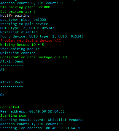

  • Here is some debug info. In the first picture, you can see my custom console.
    First, I disable the whitelist and look for the device's UUID. Having a match, I retrieve the the MAC address from the advertisement report packet and store it in FLASH. (Please ignore the message in red saying there was a problem retrieving the MAC). I re-enable the whitelist.  When an event of type whitelist request happens, the function of the code I posted above is called and executed, adding the address I had previously stored.

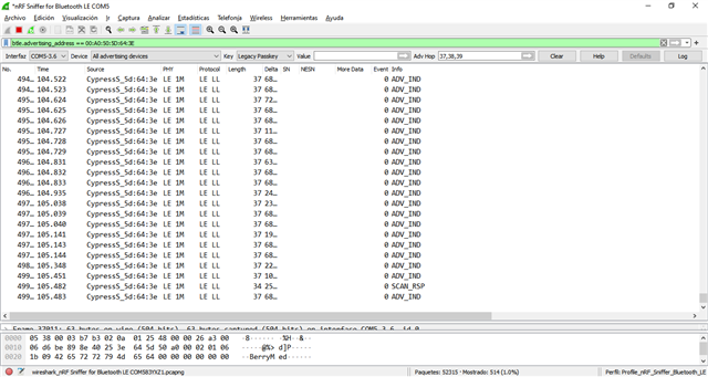

    At this point, I turn the pulse oximeter on and this is the log I have for Wireshark
    As you can see, there is no attempt of connection coming from the central
    Hope this can get you a better picture of the problem. Thanks
    Yes, this gives a bit more overview. The fact that there is no connection attempt is important.

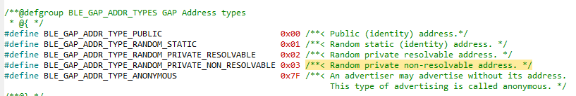

    I see you specify the address type (addr_type) as BLE_UUID_TYPE_UNKNOWN which does not really make sense, but this is defined to 0, so it is the same as if you used BLE_GAP_ADDR_TYPE_PUBLIC. The address might not be public though, and if so the bits indicating address type are 00 (see this good intro), which point to this being the fairly unusual type Non-Resolvable Random Private Address. That immediately seems a bit strange though, as you should see the address change from time to time in this case, and as it is non-resolvable you would not be able to know that it is the same device after the address changes. So it cold be that the address really is public or that I missed something.

  • Hello, Einar. That was actually very helpful specifically because, sometimes, right after I add the address to the whitelist, a Whitelist advertisement report occurs and this is the debug message I get:
    As you can see, the peer address of the device seems to have changed (?). That might point to the fact that the device does have a Non-Resolvable Random Private Address (also, the fact that the MSB are 00 too). Is there a way I can confirm this?
